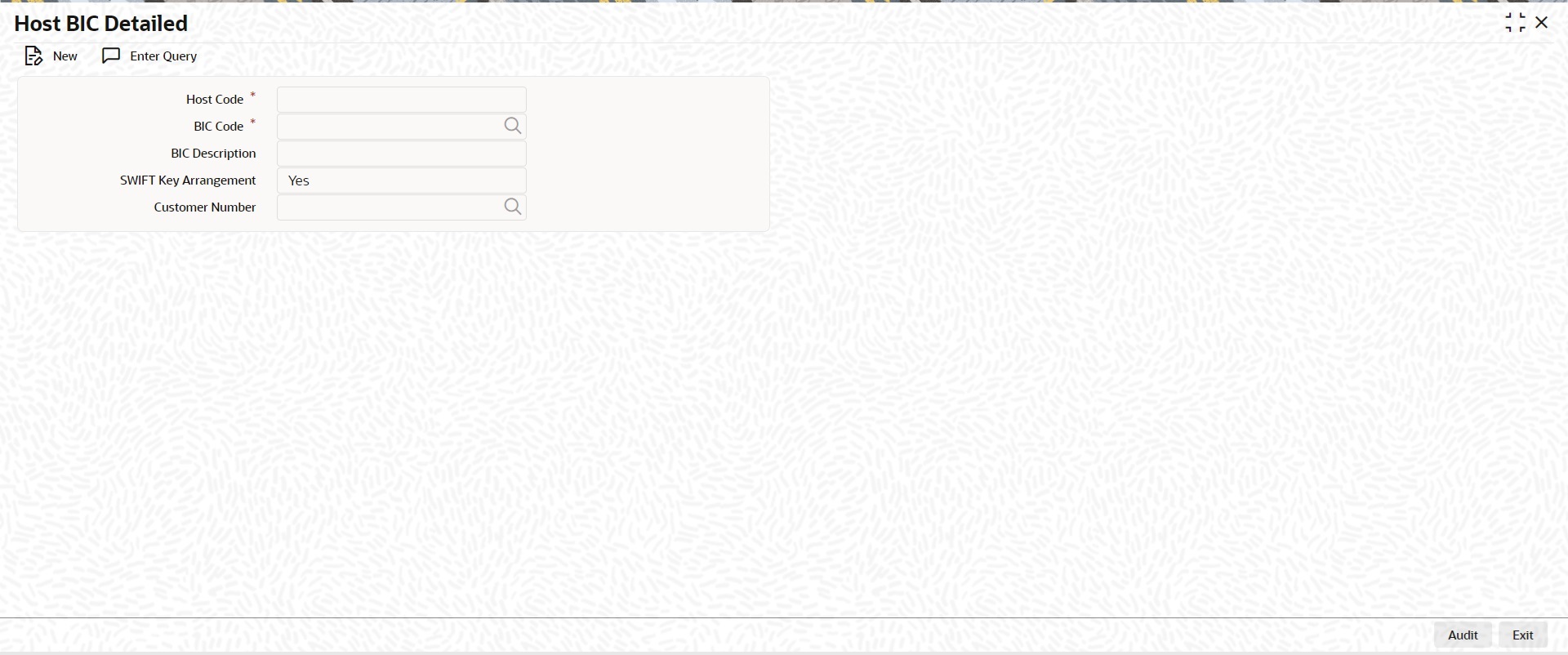

1.10.1 Host BIC
The Host BIC screen allows users to link the required BIC to a specific Host through this screen. Also, user can specify the SWIFT key arrangement specific to a customer o BIC.
  1. On Homepage, specify PMDHTBIC in the text box, and click next arrow.
    Host BIC screen is displayed.
  2. Click New button on the Application toolbar.
  3. On Host BIC screen, specify the fields.
    For more information on fields, refer to the field description below:
    Table 1-132 Host BIC - Field Description
    Field Description
    Host Code System defaults the Host Code of transaction branch on clicking ‘New’.
    BIC Code Specify the BIC Code from the list of values.
    BIC Description System defaults the Description of the BIC Code displayed.
    SWIFT Key Arrangement Specify if the SWIFT Key Arrangement is done for the host.
    Customer Number Specify the Customer Number from the list of values.
