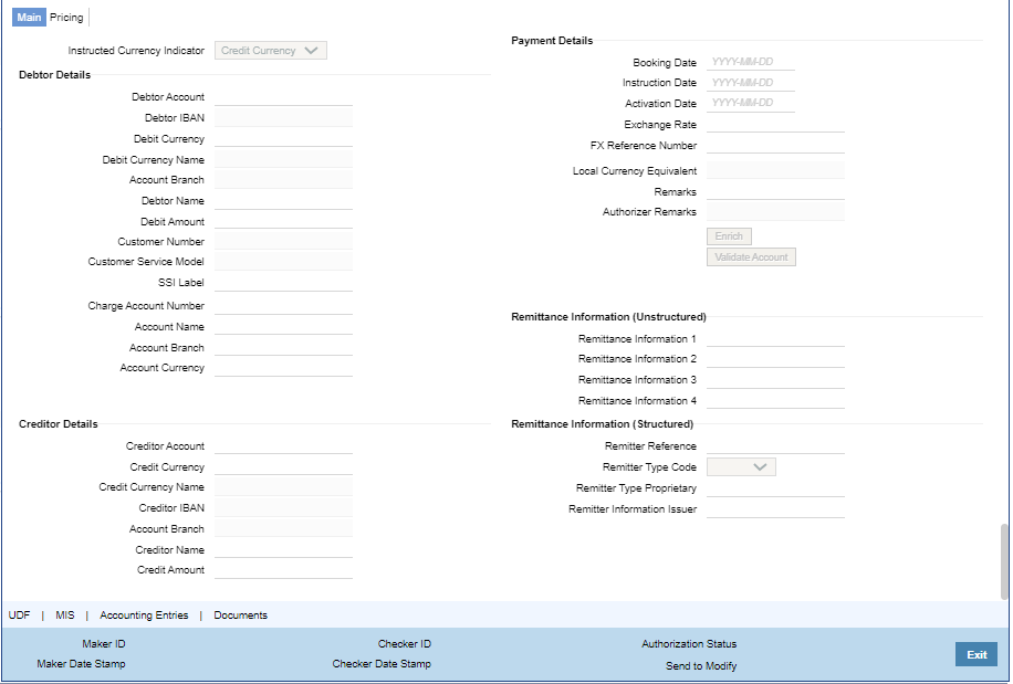

Main Tab
- Click on Main Tab in the ‘Book Transfer Transaction Input’ screen.
Figure 2-2 Book Transfer Transaction Input - Main Tab
Description of "Figure 2-2 Book Transfer Transaction Input - Main Tab" - On Main tab sub-screen, specify the fields.
For more information on fields, refer to the field description below:
