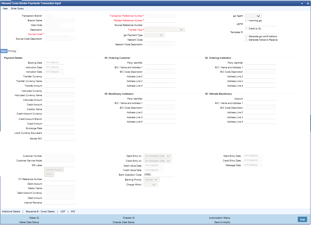

The Inbound Cross Border Payments Transaction Input screen allows users to book an Inbound SWIFT payment by providing input for the payment transaction.
- On Homepage, specify PXDITONL in the text box, and click next
arrow.Inbound Cross Border Payments Transaction Input screen is displayed.
Figure 5-1 Inbound Cross Border Payments Transaction Input
- Click New button on the Application toolbar.
- On Inbound Cross Border Payments Transaction Input screen, specify the
fields.
For more information on fields, refer to the field description below:
Table 5-1 Inbound Cross Border Payments Transaction Input - Field Description
