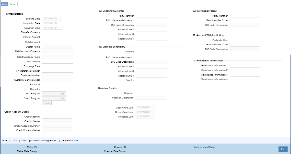

- Click the Main tab in the Outbound Cross Border gLowValue Payment
Transaction Input Detailed screen.
Figure 10-18 Outbound Cross Border gLowValue Payment Transaction Input Detailed_Main Tab
- On Main tab, specify the fields.
For more information on fields, refer to the field description below:
Table 10-9 Outbound Cross Border gLowValue Payment Transaction Input Detailed_Main tab - Field Description
Field Description Payment Details -- Booking Date Booking date is read only field defaulted as the current logged in branch date. Instruction Date Select the customer advised Value Date of the transaction using the adjoining calender widget. Activation Date System retains the Activation Date input by the user. Also, Activation date is an optional field. If the activation date is not provided, system derives the same. Activation Date is calculated in the following way:
