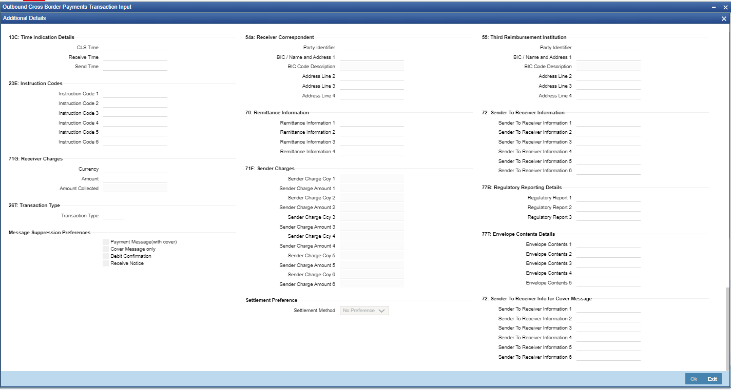

- Click the Additional Details button at the bottom of the Outbound Cross
Border Payments Transaction Input screen.The Additional Details sub-screen is displayed.
Figure 4-5 Outbound Cross Border Payments Transaction Input_Additional Details
- On Additional Details button, specify the fields.
For more information on fields, refer to the field description below:
Table 4-4 Outbound Cross Border Payments Transaction Input_Additional Details - Field Description
Field Description 53: Sender Correspondent System displays the Party Identifier, BIC code or details like Name and Address of the sender’s correspondent through which the payment transaction should be routed. This value is populated after deriving the Payment chain as part of the processing. This BIC would be present in the Currency Correspondent maintenance for the Transfer currency. Note:
