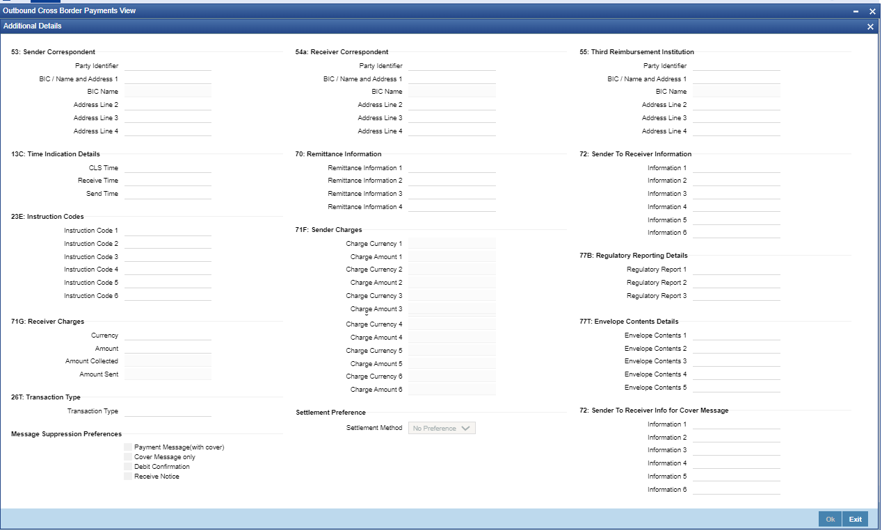

The Additional Details sub-screen allows users to capture additional information and view field values set by the system for the transaction.
- Click the Additional Details button at the bottom of the Outbound Cross
Border Payments View screen.The Additional Details sub-screen is displayed.
Figure 4-17 Outbound Cross Border Payments View_Additional Details
- On Additional Details sub-screen, specify the fields.
For more information on fields, refer to the field description below:
Table 4-9 Outbound Cross Border Payments View_Additional Details - Field Description
