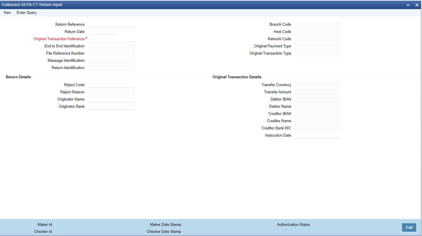

- On Homepage, specify PADOTRTN in the text box, and click next
arrow.Outbound SEPA CT Return Input screen is displayed.
- Click New button on the Application toolbar.
- On Outbound SEPA CT Return Input screen, specify the fields.
For more information on fields, refer to the field description below:
Table 2-23 Outbound SEPA CT Return Input - Field Description
Field Description Return Reference Number System defaults the return reference number. Return Date System displays the Return Date as the current date by default. New System defaults the following on clicking ‘New’ button: - Return Date

Original Transaction Reference Select the Original Payment Reference. All Outbound payments with payment type as ‘ACH’ and transaction status as ‘Processed’ or ‘Future Valued’ are listed for this field. On selecting the Original Transaction Reference, the information related to the transaction is defaulted in the following sections:

Original Transaction Details System defaults the details upon selecting a valid Original Transaction Reference. Following fields are defaulted with data: - Transfer Currency

Return Details -- Reject Code Specify the Return Reason Code. Alternatively, you can select the reason from the option list. The list displays all valid reasons maintained in the system. Note:
Only the reject codes applicable for the payment network for the operation ‘Payment Return’ are listedReject Reason System displays the Reject Reason based on the selected Reject Code. Originator Name Specifies the name of the Originator. Originator Bank Specify the Originator Bank. Alternatively, you can select the Originator Bank from the option list. The list displays all valid Originator Banks maintained in the system. Note:
You must either specify the Originator Name or the Originator Bank. - Sanction Scanning on Positive Response to Recall /Return of Outbound
