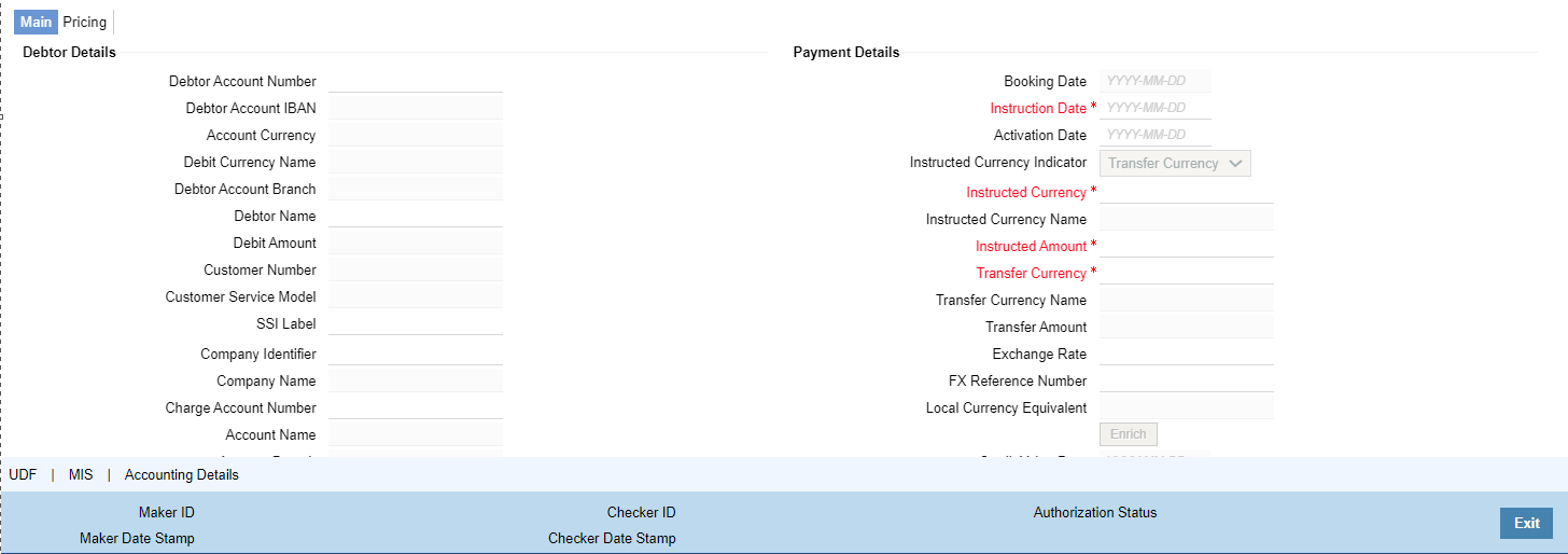

- Click on Main Tab in the ‘Outbound SEPA CT Transaction Input’ screen to
capture Creditor/ Debtor/ Payments details.
Figure 2-2 Outbound SEPA CT Transaction Input - Main Tab
Description of "Figure 2-2 Outbound SEPA CT Transaction Input - Main Tab" - Click New button on the Application toolbar.
- On Main tab, specify the fields.
For more information on fields, refer to the field description below:
Table 2-2 Outbound SEPA CT Transaction Input - Main Tab - Field Description
Field Description Debtor Details -- Debtor Account Number Specify the debtor account number. Alternatively, you can select the debtor account number from the option list. The list displays all open and authorized accounts as available in External Account Maintenance. Debtor IBAN System defaults the account IBAN based on the debtor account number field selected. Account Currency System defaults account currency based on the debtor account number selected. Debtor Account Branch System defaults the account branch based on the debtor account number selected. Debtor Name System defaults the name of the Debtor Account holder. Debit Amount System populates this field as the transfer amount converted in debtor account currency on enrich. Customer Number This field is defaulted as the customer ID of the Debtor account chosen. Customer Service Model Specifies the Customer Service Model. This is displayed if customer is linked to a service model. SSI Label Select the required SSI label from the list of values. Note:
