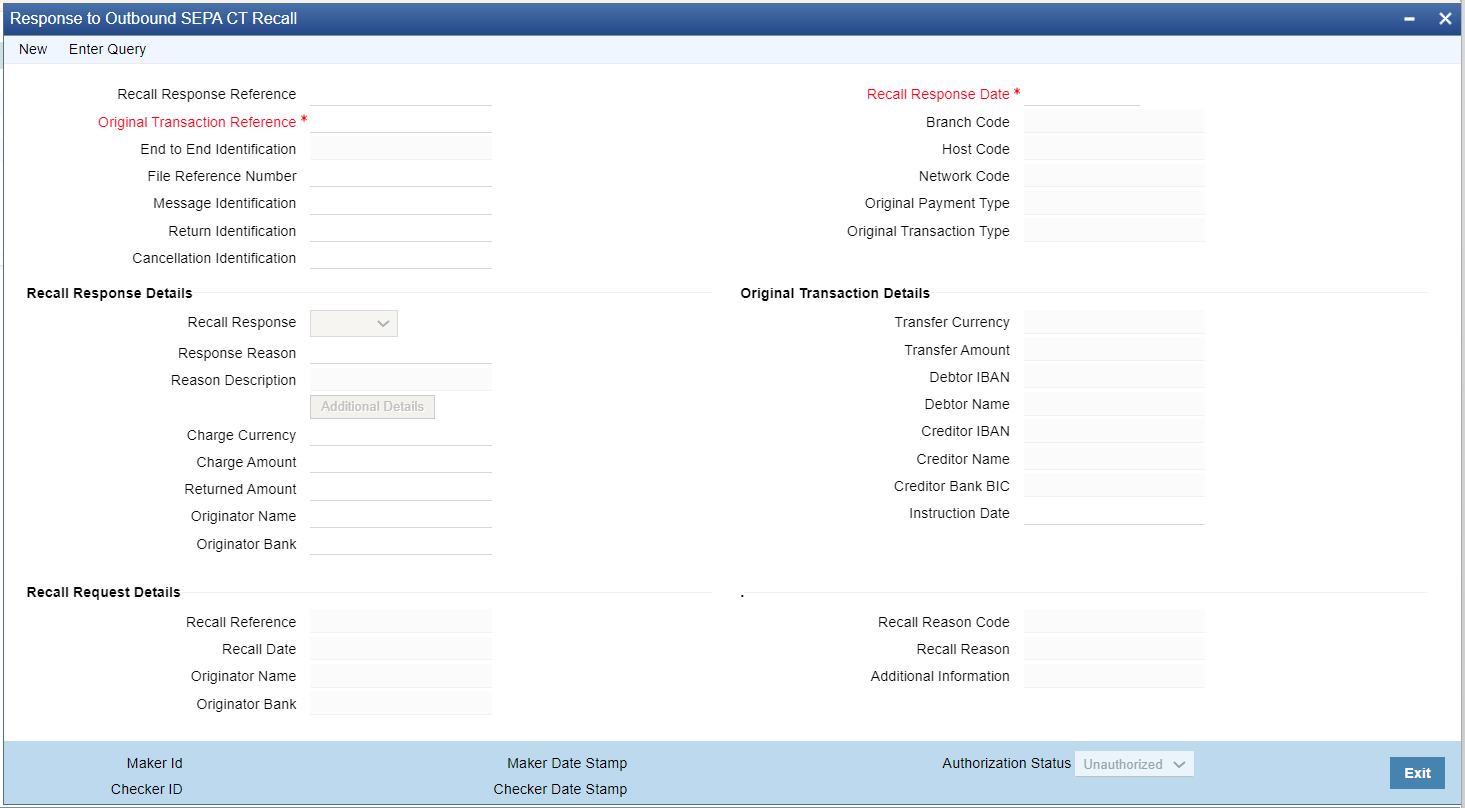

- On Homepage, specify PADRCRES in the text box, and click next
arrow.Response to Outbound SEPA CT Recall screen is displayed.
Figure 2-56 Response to Outbound SEPA CT Recall
Description of "Figure 2-56 Response to Outbound SEPA CT Recall" - Click New button on the Application toolbar.
- On Response to Outbound SEPA CT Recall screen, specify the fields.
For more information on fields, refer to the field description below:
Table 2-21 Response to Outbound SEPA CT Recall - Field Description
Field Description Recall Response Reference System defaults the recall reference number. Recall Response Date Specifies the date on which the recall was initiated. This date is defaulted as recall booking date. System defaults the following on clicking ‘New’ button:- Recall Response Date
