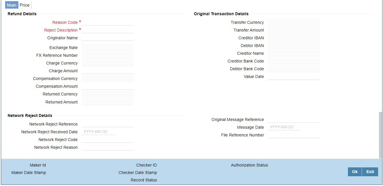

- On Main Tab, specify the fields.
Figure 5-39 Inbound Collections Refund - Main Tab
Table 5-13 Inbound Collections Refund_Main Tab - Field Description
Field Description Refund Details -- Reason Code Select the Reason Code for initiating the Refund. Reject Description System defaults the Reject Description for the Reason Code selected. Originator Name Specify the Originator Name. It is mandatory enter the name. Only customer originated refunds are allowed from this screen. Note:
Refund is applicable for Core scheme only. Collections booked under B2B scheme is not listed for initiating B2B refund requests.
While refund are uploaded (pacs.004 messages with Originator name), the validation is based on Recall allowed period.
When the reason code is MD01, system validates for unauthorized refund period and in other cases it validates for the normal refund period.
Exchange Rate Specify the Exchange Rate. FX Reference Number Specify the FX Reference Number. Charge Currency This field displays Currency of the Charge amount. Charge Amount Specify the Charge Amount specified by the Debtor PSP. Compensation Currency This field displays Currency of the compensation amount. Compensation Amount Specify the Compensation amount specified by the Debtor PSP. Returned Currency This field displays Currency of the returned amount. Returned Amount This field displays Total amount returned by the Creditor PSP. Note:
