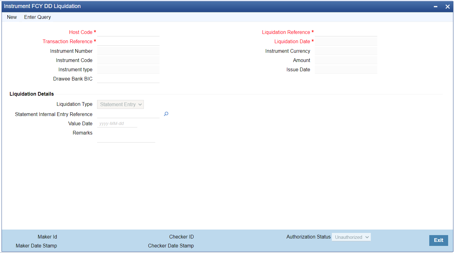

You can define the instrument codes through this screen.
- On Homepage, specify PIDFCYLQ in the text box, and click next
arrow.Instrument FCY DD Liquidation screen is displayed.
- Click New button on the Application toolbar.
- On Instrument FCY DD Liquidation screen, specify the fields.
Table 2-18 Instrument FCY DD Liquidation - Field Description
Field Description Host Code System defaults the Host Code of transaction branch on clicking ‘New’. Transaction Reference Specify the Transaction Reference from the list of values. System lists the instrument issue transactions where:- Transaction with Instrument Type as FCY DD
- Transaction status is liquidated and CRLQ is pending
Based on the transaction number selected , below fields are defaulted:- Instrument Number
- Instrument Code
- Instrument Type
- Drawee Bank BIC
- Instrument Currency
- Amount
- Issue Date
Liquidation Reference System displays the Liquidation Reference on clicking ‘New’. Liquidation Date System displays the Liquidation Date as current date. Liquidation Details -- Liquidation Type Select the Liquidation Type from the following: - Statement Entry (Default)
- Adhoc
Statement Internal Entry Reference Specify the Statement Internal Entry Reference from the list of values. This field is mandatory if the Liquidation type is selected as 'Statement Entry'. Value Date Value Date is defaulted on Statement Internal Entry Reference selected. This field is to be manually input if Adhoc option is selected. Remarks Specify the Remarks.
On authorization of the record, system will complete the credit liquidation of the instrument issue transaction selected.
