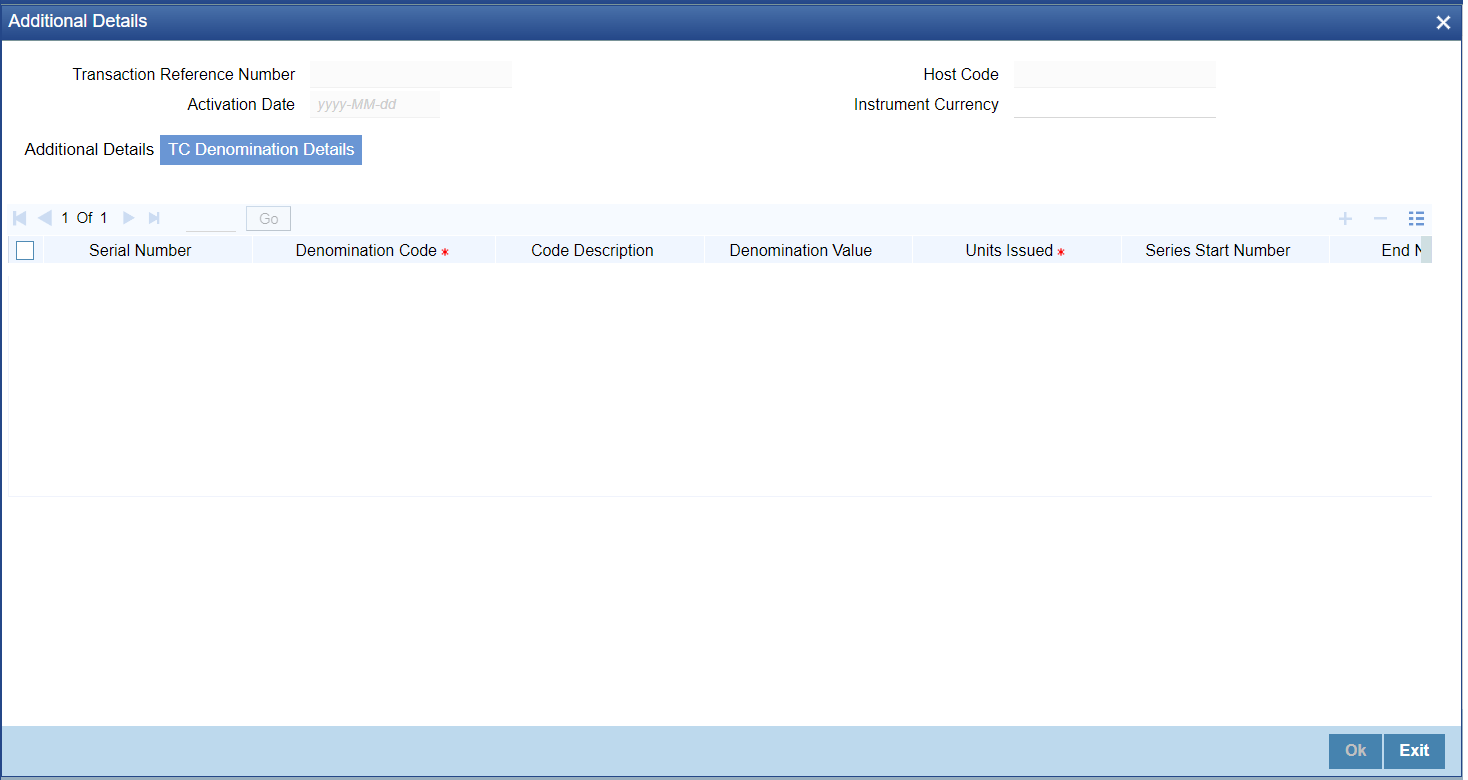

- Denomination details tab is enabled only if the Instrument Type is TC.
- You can specify the additional beneficiary details by clicking the TC
Denomination Details button.
Figure 2-22 Additional Details - TC Denomination Details
Description of "Figure 2-22 Additional Details - TC Denomination Details" - On TC Denomination Details sub screen, specify the fields.
Table 2-13 Additional Details - TC Denomination Details - Field Description
Field Description Serial Number System generates the Serial Number. Denomination Code Specify the Denomination Code from the list of values. Lists all the codes maintained for the instrument code in PIDDENOM. Code Description Code Description is defaulted based on the Denomination Code selected. Denomination Value Denomination Value is defaulted based on the Denomination Code selected. Units Issued Specify the Issued Units. Series Start Number If the instrument number generation is 'Auto', then Start Series Number is populated by system. You can manually enter the Series Start Number if the instrument generation is manual. End Number Based on the Units Issued, End Number is populated. You can manually enter the Series End Number if the instrument generation is manual. Total Value Total Value is calculated by the system by multiplying the Denomination value with the units issued.
