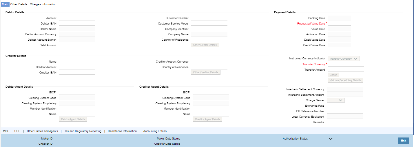

- Click on Main tab on the Originated ACH Credit Transfer Input
screen.Main tab sub-screen is displayed.
Figure 2-37 Originated ACH Credit Transfer Input - Main Tab
Description of "Figure 2-37 Originated ACH Credit Transfer Input - Main Tab" - On Main Tab sub-screen, specify the fields.
For more information on fields, refer to the field description below:
Table 2-22 Originated ACH Credit Transfer Input -Main Tab - Field Description
Field Description Debtor Details -- Account Specify the Account Number from the list of values. All valid accounts in the system are listed which are allowed to be operated for the Host is listed. You can specify a valid GL also in the Account field. In this case, the prefunded GL flag gets checked automatically on Enrich/Save. If the Prefunded GL field value is 'Yes', system allows any account number in Account field which is or not available in External account maintenance.
Debtor IBAN If Debtor IBAN is maintained for the account for the Network code, the same is populated. Note:
If both, Account and IBAN are available for the Debtor/Creditor, IBAN is populated in Debtor Account details when pacs.008 message is generated.Debtor Name System defaults the Debtor Name, based on the Account selected. Debtor Account Currency System defaults the Debtor Account Currency, based on the Account selected. Debtor Account Branch System defaults the Debtor Account Branch, based on the Account selected. Debit Amount Specify the Debit Amount. If the Instructed Currency indicator is 'Transfer Currency', then the Debit Amount field is a system derived one. Customer Number Specify the Customer Number linked to the Debtor Account. Customer Service Model Specify the Customer Service Model, If the Service Model linkage is available for the customer. Company Identifier Specify the Company Identifier from the list of values. All valid company identifiers as available in Originator Details maintenance PMDORGDT. Company Name System defaults the Company Name, based on the Company Identifier selected. Country of Residence Specify the Country of Residence from the list of values. Lists the country of the customer account from STDCRACC, if not available, populated from STDCIFCR. Other Debtor Details This button opens a Debtor Details Tab in which Postal Address, multiple Identification details, Contact details and Account other details of the Debtor can be added. The Unstructured address lines are populated from the address available in External Account maintenance STDCRACC. You can edit all the address fields, once defaulted.
Creditor Details -- Name Specify the Creditor Name. Creditor Account Specify the Creditor Account. Creditor IBAN Specify the Credit IBAN, if it is applicable for the Network. Creditor Account Currency Specify the Creditor Account Currency from the list of values. Lists valid currency codes. Country of Residence Specify the Country of Residence from the list of values. Lists all valid country codes. Other Creditor Details This button opens the Other Creditor Details tab. You can specify the Postal Address, multiple Identification details, Contact details and Account other details of the Creditor. Payment Details -- Booking Date System defaults this field to current date. Requested Value Date Specify the Requested Value Date. Value Date System derives Value Date based on the ACH CT Date Derivation logic. If the Requested value date entered is a past date, it is moved forward to current date. Activation Date System derives Activation Date. Debit Value Date Debit Value date is same as the Value Date derived. Credit Value Date Debit Value date is same as the Value Date derived. Instructed Currency Indicator Select Instructed Currency Indicator from the following: - Transfer Currency (Default)
- Debit Currency
Transfer Currency The Currency linked to the Network Code is defaulted in this field. Transfer Amount If the Instructed Currency Indicator is 'Transfer Currency' it is mandatory to specify the Transfer Amount. Interbank Settlement Currency This field value is same as Transfer Currency. Interbank Settlement Amount This field value is same as Transfer Amount. Charge Bearer Select Charge Bearer from the following: - DEBT
- CRED
- SHAR
- SLEV
The Charge option supported for processing is SHAR.Exchange Rate Specify the Exchange rate or system fetches the exchange rate based on the FX preferences maintained for the Network in ACH Credit Transfer Preferences PYDONPRF. FX Reference Number Specify the FX Reference Number, if any. Local Currency Equivalent This field displays Local Currency Equivalent of the Transfer Amount. Remarks Specify any internal Remarks related to the transaction. Debtor Agent Details -- BICFI System defaults Transaction Branch BIC. Clearing System Code This field is defaulted from ACH Network Details Function ID: PMDACHNW. Clearing System Proprietary This field is defaulted from ACH Network Details Function ID: PMDACHNW. Member Identification This field is defaulted as the Member ID for the Branch defined in Branch Identifier Maintenance PMDACHBR. Note:
Clearing system code/proprietary fields cannot have values without the Member ID details.Name Specify the Debtor Agent Name from ACH Directory details, if the Member ID is listed. If only BIC is available, the Name is populated from the BIC Directory details. Debtor Agent Details Specify the Debtor Agent Details from ACH Directory details, if the Member ID is listed. If only BIC is available, the Name is populated from the BIC Directory details. Creditor Agent Details -- BICFI Specify the BICFI from the list of values. All valid BIC codes are listed. Clearing System Code This field is disabled. The code is populated based on the Creditor Agent Member ID selected. Clearing System Proprietary This field is disabled. The code is populated based on the Creditor Agent Member ID selected. Member Identification Specify the Member Identification from the list of values. All valid Clearing codes maintained in ACH Network Directory PMDACHDR for the Network Key of the Transaction Network are listed. Name Specify the Bank Name. It is mandatory to have either the BIC or Member ID selected for the Creditor Agent. Creditor Agent Details Bank Address details are populated based on the Member ID selected from the ACH Directory details. If Member ID is not available the address details are populated from the BIC selected. It is mandatory to have either the BIC or Member ID selected for the Creditor Agent. Enrich The following actions are completed, when you click Enrich button: - Derivation of Processing Dates is done for the UI entered transactions at the time of Enrich
