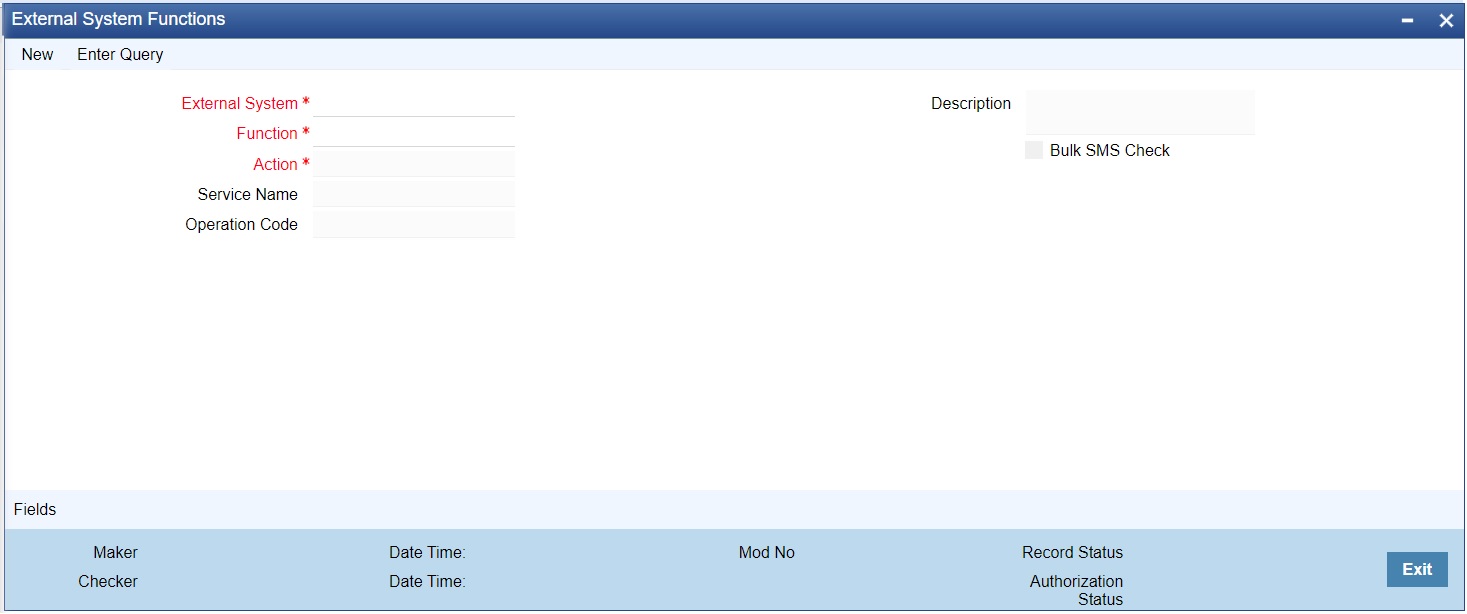

External System Functions Maintenance
Maintain the gateway preferences for the below Source codes for the service
name“FCUBSEPSService” with operation code “CreateEPSNotification” to receive the
notifications from OBPM:
- FCUBSCL
- FCUBSRT
- FCUBSTD
For all FCUBS corporate modules where outgoing payment is initiated, the source code will be “FCUBS <Module-ID>”. For example, the source code for FX module will be “FCUBSFX”
Maintain the gateway preferences for the below Source codes for the service name “PMDDOutService” with operation code “CreateDDOutService” to receive the notifications from OBPM:
- FCUBSCL
Parent topic: Maintenance to be done in FCUBS
