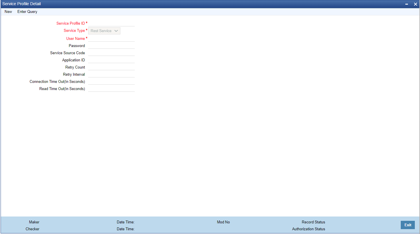

Service Profile ID (PMDSPROF):

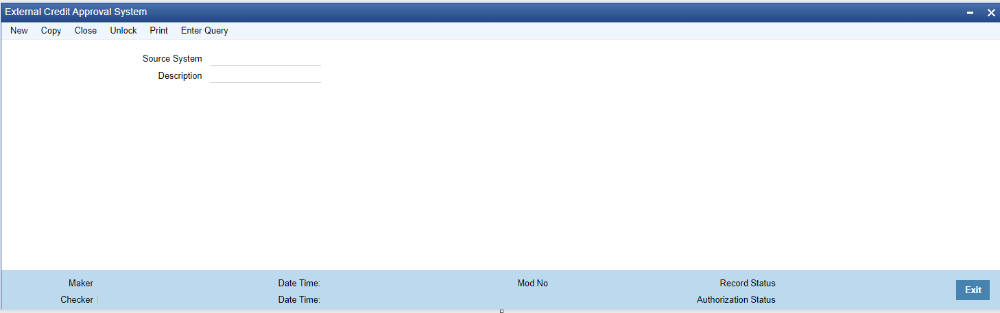

ECA System Maintenance (STDECAMT)
Figure 2-15 External Credit Approval Check system

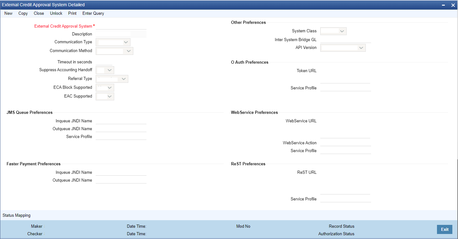

External Credit Approval System (PMDECAMT)
- ECA System Class should be ‘OBTF’
- Inter System Bridge GL should be with appropriate value. It should be in same as interbridge GL maintained at OBTF product processor in function id “IFDTFEPM – Trade Finance External System Maintenance”.
- Communication Type should be ‘Webservice’
- Communication Method should be ‘Synchronous’
- Webservice URL should contain the URL of OBTF system where EAC check will be done. (E.g. http://<URL>/OBTFEPSService/OBTFEPSService?WSDL)
- Service Profile should be the ‘Webservice’ type Service profile created.
Figure 2-16 External Credit Approval System

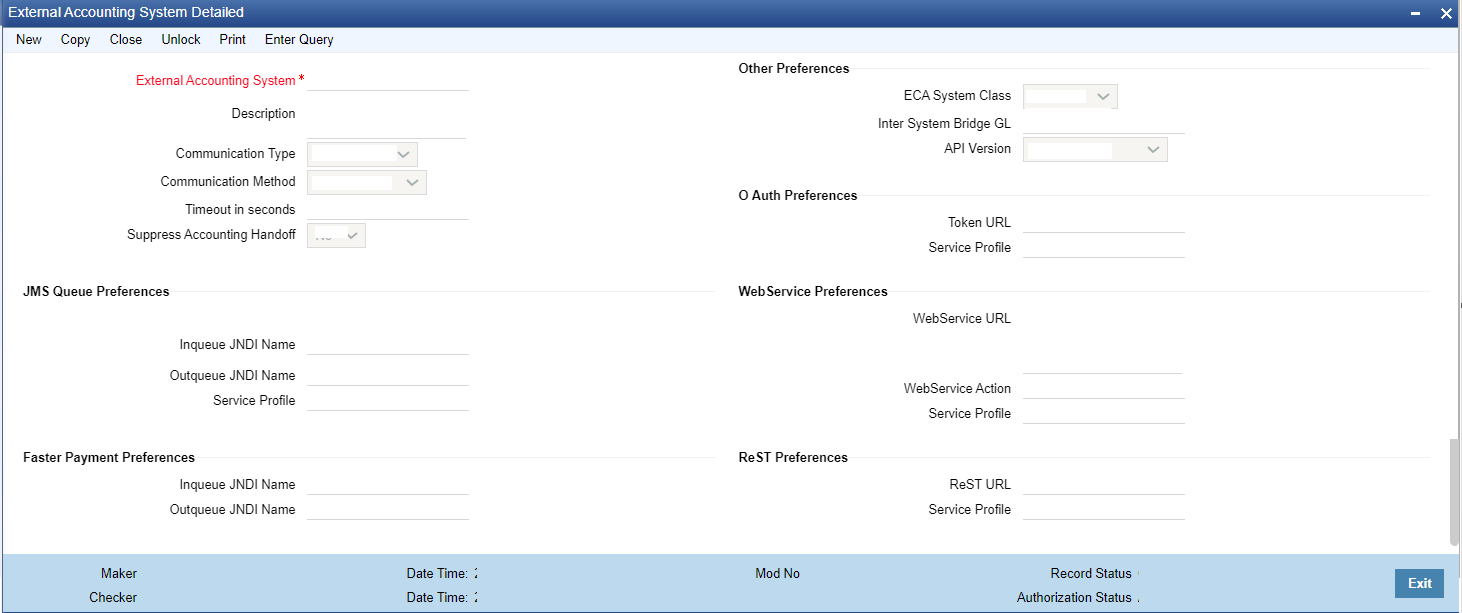

External Accounting System Detailed (PMDACCMT)
- Webservice URL should contain the URL of OBTF system where accounting will be done.
- Service Profile should be the Webservice profile created.
- Account System Mapping to be done based on the requirement.
Figure 2-17 External Accounting System Detailed

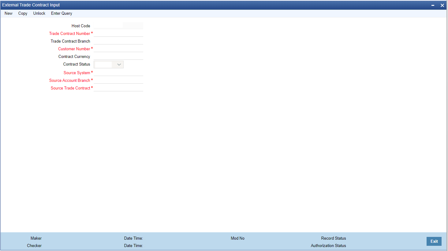

External Trade Contract (STDCRTRD)

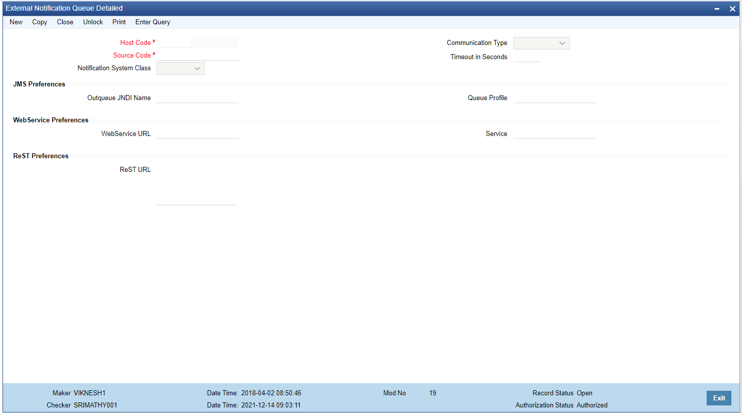

External Notification Queue (PMDEXTNT)
Figure 2-19 External Notification Queue Detailed

On export bill creation Bill related details will be exposed to common core system screen External Trade Contract Input (STDCRTRD) using common core service FCUBSCoreentitiesService and operation CreateExternalTrade. OBPM system uses the common core External Trade Contract Input data for an Incoming MT202 to Bills.

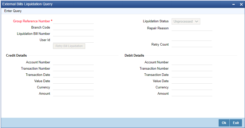

External Bill Liquidation Query and Retry
External Bill Query screen allows the user to resolve the technical failures in case of EArequest. Whenever an EA request is received from Payments through GW Webservice, Liquidation gets triggered by OBTF.
If Liquidation triggered by OBTF did not processed successfully, then retry liquidationprovided in IFDEXLIQ to be enabled for repaired process records.
On click of retry liquidation external liquidation to be triggered automatically till the retry count provided in "Bills Branch Parameter maintenance” screen.
If external liquidation from external system is failed corresponding Bill should not be allowed for further operations except Query and Copy.
Figure 2-21 External Bill Liquidation Query
The system displays the liquidation status. The list displays the following options:
| Liquidation Status | Description |
| Un Processed | Bill liquidation is pending for processing |
| Processed | Bill liquidation processed successfully |
| Processing Failed | Bill liquidation processing failed due to unexpected failure |
| Improper Notification | Bill liquidation received is not in proper format |
| Empty Notification | Bill liquidation notification received |
