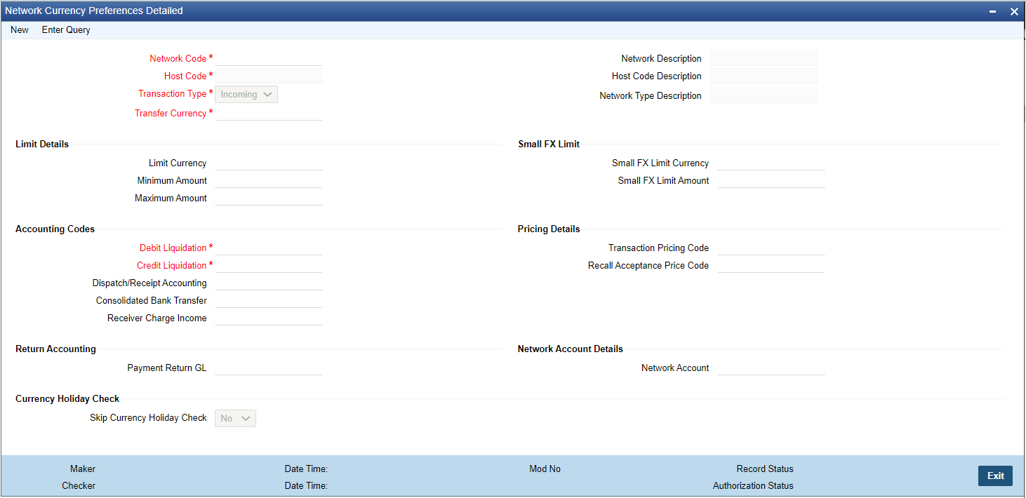

- On Homepage, specify PMDNCPRF in the text box, and click next arrow.Network Currency Preference Detailed screen is displayed.
Figure 2-39 Network Currency Preference Detailed
Description of "Figure 2-39 Network Currency Preference Detailed" - Click New button on the Application toolbar.
- On Network Currency Preference Detailed screen, specify the fields.For more information on fields, refer to the field description below:
Table 2-23 Network Currency Preference Detailed - Field Description
Field Description Network Code Specify the network code. Alternatively, you can select the network code from the option list. The list displays all valid network codes applicable for the logged in Host. Network Description System defaults the description of the Network Code selected. Host Code System defaults the host code of transaction branch on clicking ‘New’. Host Code Description System defaults the description of the Host code displayed. Transaction Type Select transaction type from the following: - Inbound
- Outbound
Network Type Description System displays the Network Type Description based on the network code. Transfer Currency Specify the transfer currency. Alternatively, you can select the transfer currency from the option list. The list displays all valid currency codes maintained in the system. *AL currency would be listed and would be applicable for SWIFT & BOOK transfer payment types. Note:
Selection of the *AL value in this Currency field indicates that the Network Currency Preferences record is applicable to transactions for the selected Network in all currencies of the selected Transaction Type (Outbound or Inbound).Limits Details -- Limit Currency Specify the limit currency. Note:
This field is enabled for input only when Transfer Currency field has *AL value. You can input any valid currency (other than *AL).Minimum Amount Specify the minimum transaction amount. Maximum Amount Specify the maximum transaction amount. Note:
Payments booked should have transaction amount between the minimum and maximum amount specified in the transaction currency. If the transaction amount is not in the specified range, the system displays an error message.Small FX Limit -- Small FX Limit Currency Specify the small FX limit currency code. Alternatively, you can select the currency code from the option list. The list displays all valid currency codes maintained in the system. Small FX Limit Amount Specify the Small FX Limit Amount. Accounting Codes -- Debit Liquidation Specify the accounting code for debit liquidation. Alternatively, you can select the debit liquidation code from the option list. The list displays all accounting codes where main transaction is maintained with debit indicator. Credit Liquidation Specify the accounting code for credit liquidation. Alternatively, you can select the credit liquidation code from the option list. The list displays all accounting codes where main transaction is maintained with credit indicator. Dispatch/Receipt Accounting Specify the accounting code for dispatch accounting. Alternatively, you can select the dispatch accounting code from the option list. The list displays all valid codes maintained in the system. Note:
