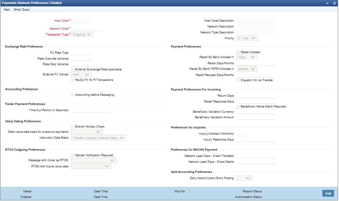

- On Homepage, specify PMDNWPRF in the text box, and click next arrow.Payment Network Preferences Detailed screen is displayed.
Figure 2-41 Payment Network Preferences Detailed
Description of "Figure 2-41 Payment Network Preferences Detailed" - Click New button on the Application toolbar.
- On Payment Network Preferences Detailed screen, specify the fields.For more information on fields, refer to the field description below:
Table 2-24 Payment Network Preferences Detailed - Field Description
Field Description Network Code Specify the network code. Alternatively, user can select the network code from the option list. The list displays all valid network codes applicable for the logged in Host, maintained in the system. Network Description System displays the network code description for the selected network. Host Code System defaults the host code of transaction branch on clicking ‘New’. Host Code Description System defaults the description of the Host code displayed. Transaction Type Select Transaction Type from the following: - Incoming
