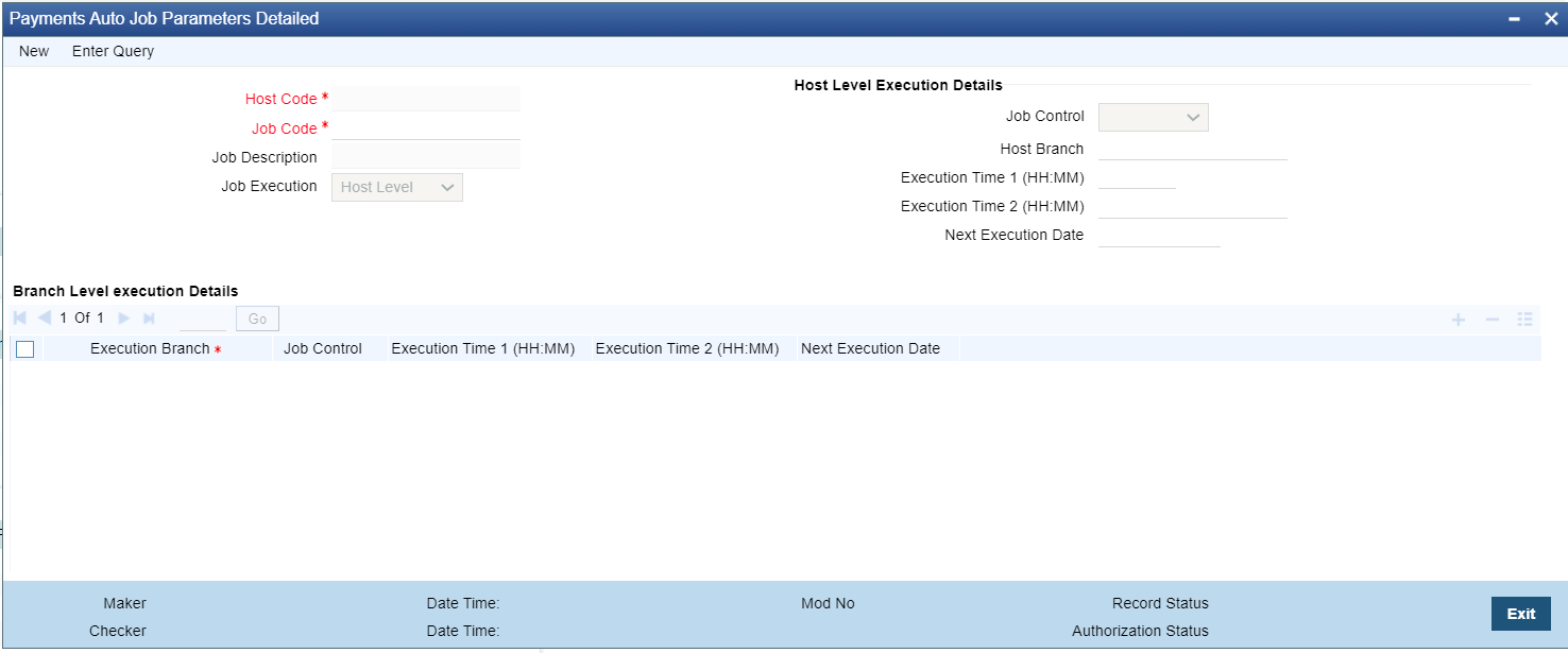

- On Homepage, specify PMDAJBPR in the text box, and click next arrow.Payments Auto Job Parameters Detailed screen is displayed.
Figure 2-151 Payments Auto Job Parameters Detailed
Description of "Figure 2-151 Payments Auto Job Parameters Detailed" - Click New button on the Application toolbar.
- On Payments Auto Job Parameters Detailed screen, specify the fields.For more information on fields, refer to the field description below:
Table 2-82 Payments Auto Job Parameters Detailed - Field Description
Field Description Host Code System defaults the host code of transaction branch on clicking ‘New’. Job Code Select the job code from the list of values. Note:
For Job Code list details, refer to reference documents 'OBPM Auto Seed Job Details'.Job Description This is defaulted based on the selected code. Job Execution Select Job Execution from following: - Host Level
- Branch Level
Host Level Execution Details -- Job Control This field has the drop-down value as Automatic or manual. If ‘Automatic’ option is selected, the next execution date derivation will be automatic. If the option selected is manual, user has to manually update the execution date every time. Host Branch The branch selected in this field will be used for checking the local branch holidays for deriving the next execution date for the job. Any valid branch linked to the Host can be selected. Execution Time 1 (HH:MM) If the Job Control is 'Auto', it is mandatory to specify the Execution Time 1 in HH:MM format. Execution Time 2 (HH:MM) This field is allowed only if job control is auto and Execution Time 1 is present. This is an optional field. Execution time 2 has to be greater than execution time 1. Next Execution Date Specify the date when the first time maintenance is done for a job. This can be current date or future date if Job control is 'Auto'. Note:
If the job is to be run multiple times a day, you must manually amend the execution time in the maintenance.Branch Level execution Details Specify the following details:
- Execution Branch
- Job Control
- Execution Time 1 (HH:MM)
- Execution Time 2 (HH:MM)
- Next Execution Date
For a job code either Host Level Execution details or Branch Level execution details can be maintained.
