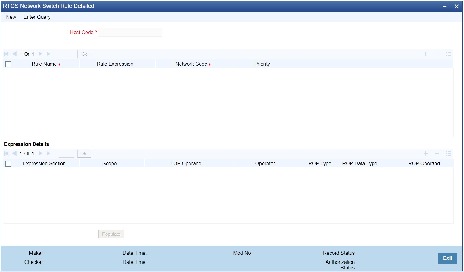

RTGS Network Switch Rule
This rule is applied when Network cutoff is over for a RTGS payment. Only network of type RTGS is allowed for switching.
If the network cut-off for the originally derived RTGS network is missed, then system checks if Network Switching rules are maintained. If available, system derives alternate RTGS network, based on rule conditions, provided the network cut-off for the alternative is not already passed.
- System then sends out the RTGS message to the alternative that is derived from the rules.
However, if the alternative could not be derived because the network cut-off time for the same is already passed then system moves the transaction to the Network Cut-off queue with the original RTGS network code.
- Manual carry forward or Auto roll-over from this queue would always result in the payment being processed for the original network on the rolled over date.
