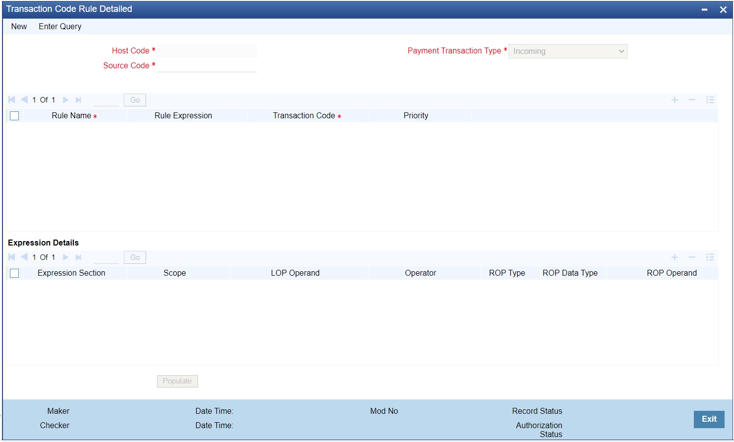

- On Homepage, specify PMDTRRLE in the text box, and click next
arrow.Transaction Code Rule screen is displayed.
- Click New button on the Application toolbar.
- On Transaction Code Rule screen, specify the fields.For more information about the fields, refer to field description below:
Table 2-153 Transaction Code Rule - Field Description
Field Description Host Code System defaults the Host Code of transaction branch on clicking ‘New’. Source Code Specify the Source Code from the list of values. Payment Transaction Type Select Payment Transaction Type from the following: - Incoming

Rule Name Specify the Name of the Rule. Rule Expression The expression can be filled in the Expression Details multi block. On the click of Populate button, the expression gets built and displayed in this field. Transaction Code Specify Transaction Code from the list of values. Note:

Priority Specify the priority number for rule execution. Expression Details -- Expression Section Specify the unique sequence number for the expression defined. Scope Start Specify the Scope assigned to the Left operand. LOP Operand Specify Left Operand value from the list of values displayed pertaining to the Transaction Code selected. Note:
