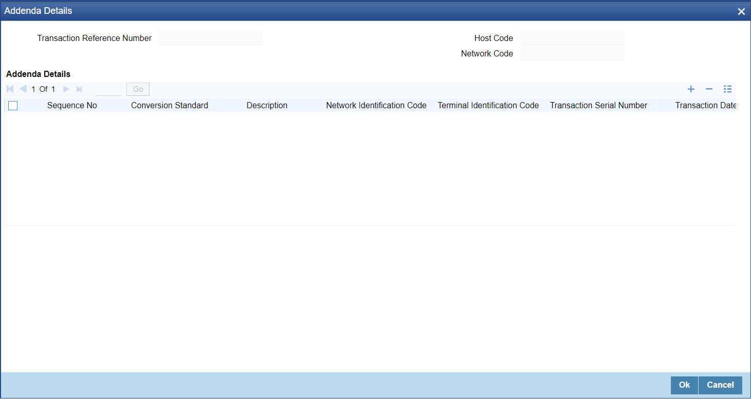

- Click on Addenda Details button.
- On Addenda Details sub screen, specify the fields.
Table 2-38 Main Tab_Addenda Details - Field Description
Field Description Transaction Reference Number System displays the Transaction Reference Number. Host Code System displays the Host Code. Network Code System displays the Network Code. Addenda Details System defaults following fields:- Sequence No
