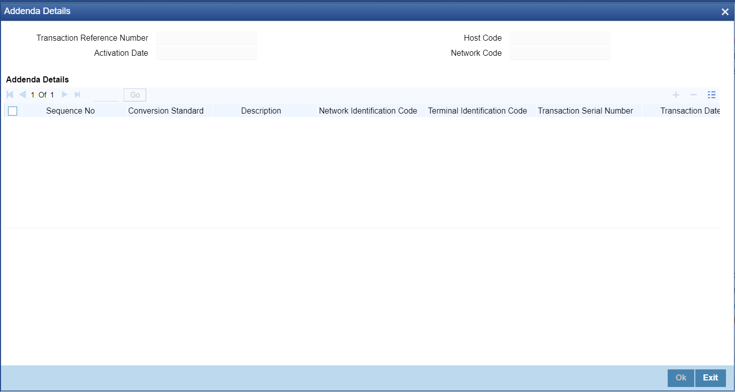

- Click on Addenda Details button.
- On Addenda Details sub screen, specify the fields.
Table 2-24 Main Tab_Addenda Details - Field Description
Field Description Transaction Reference Number System displays the Transaction Reference Number. Host Code System displays the Host Code. Activation Date Specify the Activation date. Network Code System displays the Network Code. Addenda Details System defaults following fields:- Sequence No
- Description
- Network Identification Code
- Terminal Identification Code
- Transaction Serial Number
- Transaction Date
- Transaction Time
- Terminal Location
- Terminal City
- Terminal State
- Reference Information #1
- Reference Information #2
- Authorization Code or Card Expiration Date
Conversion Standard Select one of the following standards using which the data in this field needs to be converted, during generation of the Addenda records in the NACH file: - ASCX12.5 (Interchange Control Structure)
- ASCX12.6 (Application Control Structure)
- Payment related UN/EDIFACT syntax
- ANSI ASCX12 transaction set containing a BPR or BPS data segment
Payment Related Info Specify Payment Related Info. Data only up to 80 characters would be allowed since only a Max. of 9,999 Addenda record is allowed for single CT transaction. Addenda record is optional for these SEC codes.
