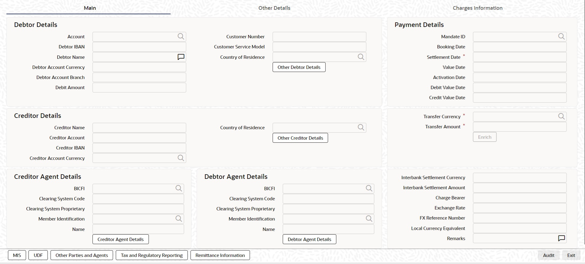

7.1.5.1 Main Tab
  1. On Main Tab, specify the fields.
    Figure 7-2 ACH Debit Receipts Input - Main Tab
    Description of Figure 7-2 follows
    Description of "Figure 7-2 ACH Debit Receipts Input - Main Tab"
    Table 7-2 ACH Debit Receipts Input_Main Tab - Field Description
    Field Description
    Debtor Details --
    Account Specify the Account from the list of values. All valid accounts in the system are listed that are allowed to be operated for the User's logged in Host.
    Debtor IBAN If Debtor IBAN is maintained for the account for the Network code, the same is populated.
    Debtor Name This field is defaulted as Debtor Name based on the Debtor Account selected.
    Debtor Account Currency This field is defaulted as Debtor Account Currency based on the Debtor Account selected.
    Debtor Account Branch This field is defaulted as Debtor Account Branch based on the Debtor Account selected.
    Debit Amount Debit Amount field is system derived one.
    Customer Number The Customer Number linked to the Debtor Account is populated.
    Customer Service Model If Service Model linkage is available for the customer, this is populated in this field.
    Country of Residence The country of the customer is populated from STDCRACC listed in list of values. This field lists the 2-Char ISO Country code list from the factory-shipped table.
    Other Creditor Details Debtor unstructured address is populated from STDCRACC. Specify the Postal Address, multiple Identification details, Contact details and Account other details of the Debtor.
    Creditor Details --
    Creditor Name Specify the Creditor Name.
    Creditor Account Specify the Creditor Account.
    Creditor IBAN Specify the Creditor IBAN, if it is applicable for the Network.
    Creditor Account Currency Specify the Creditor Account Currency from the list of values. All valid currencies are listed for the field.
    Country of Residence Specify the Country of Residence from the list of values. This field lists the 2-Char ISO Country code list from the factory-shipped table.
    Other Creditor Details Specify the Postal Address, multiple Identification details, Contact details and Account other details of the Creditor.
    Creditor Agent Details --
    BICFI Specify the BICFI from the list of values. All valid BIC codes are listed for this field.
    Clearing System Code This is a disabled field. The code is populated based on the Creditor Agent Member ID selected.
    Clearing System Proprietary This is a disabled field. The code is populated based on the Creditor Agent Member ID selected.
    Member Identification Specify the Member Identification from the list of values. Lists all valid Clearing codes maintained in ACH Network Directory PMDACHDR for the Network Key of the Transaction Network.
    Name Bank Name is populated based on the Member ID selected from the ACH Directory details. If Member ID is not available the Name is populated from the BIC selected.
    Creditor Agent Details are populated based on the Member ID selected from the ACH Directory details. If Member ID is not available the details are populated from the BIC selected.
    It is mandatory to have either the BIC or Member ID selected for the Creditor Agent.
    Debtor Agent Details Debtor Agent details are system populated.
    BICFI Transaction Branch BIC is defaulted.
    If the Branch Identifier details are maintained in Branch Identifier Maintenance PMDACHBR, then Clearing System Code/Proprietary field and Member ID gets defaulted.
    Clearing System Code This field is defaulted from ACH Network Details Function ID: PMDACHNW.
    Clearing System Proprietary This field is defaulted from ACH Network Details Function ID: PMDACHNW.
    Member Identification This field is defaulted as the Member ID for the Branch defined in Branch Identifier Maintenance PMDACHBR.
    Clearing system code/proprietary fields cannot have values without the Member ID details.
    Name Debtor Agent Name is populated from ACH Directory details if the Member ID is listed. If only BIC is available, the Name is populated.
    Debtor Agent Detail Debtor Agent details are populated from ACH Directory details if the Member ID is listed.
    Payment Details --
    Mandate ID Specify the Mandate ID from the list of values.
    Booking Date Booking Date is defaulted as current date.
    Settlement Date Specify the Inter-bank Settlement Date received in the pacs.003 message.
    Value Date If the settlement date entered is a back date, The Value Date is derived based on the Network preference for 'Back Value Date Handling'. If the preference is to 'Adjust to Current Date', the back value date to be moved to current date and holiday check to be applied. If the preference is to 'Retain as Original Value Date', then the settlement date input is retained as Value Date.
    Activation Date If the settlement date entered is a back date, The Activation Date is derived based on the Network preference for 'Back Value Date Handling'. If the preference is to 'Adjust to Current Date', the back value date to be moved to current date and holiday check to be applied. If the preference is to 'Retain as Original Value Date', then the settlement date input is retained as Activation Date.
    Debit Value Date Debit Value Date is derived based on the date derivation logic for ACH DD Receipts on Enrich/save.
    Credit Value Date Credit Value Date is derived based on the date derivation logic for ACH DD Receipts on Enrich/save.
    Transfer Currency The Currency linked to the Network Code is defaulted in this field if the Network allows single currency. If all currencies are allowed by the Network, transfer currency list of values lists all valid currencies.
    Transfer Amount If the Instructed Currency Indicator is 'Transfer Currency' it is mandatory to specify the Transfer Amount.
    Enrich The following actions are completed on clicking the Enrich button:
    • Derivation of Processing Dates are done
    • Internal Exchange rate fetch and price details population
    You can change the transaction details and do the Enrich again to fetch the values.
    Interbank Settlement Currency This field is same as Transfer currency.
    Interbank Settlement Amount This field is defaulted as Transfer Amount.
    Charge Bearer Select the Charge bearer from the following:
    • DEBT
    • CRED
    • SHAR
    • SLEV
    Exchange Rate Specify the Exchange rate or system fetches the value based on the FX preferences maintained for the Network in ACH Debit Receipt Preferences ‘PZDINPRF’.
    FX Reference Number For a currency transaction, you can specify the FX reference, if it is available.
    Local Currency Equivalent This field displays Local Currency Equivalent of the Transfer Amount.
    Remarks Specify any internal Remarks related to the transaction.
