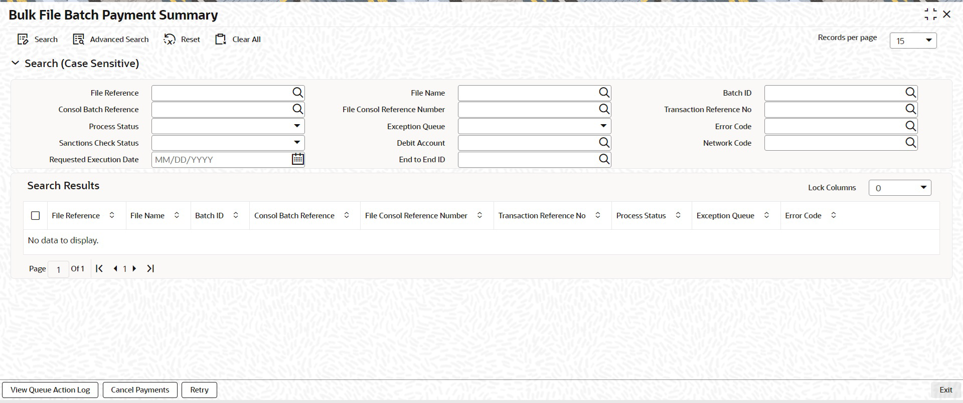

2.2.9 Batch File Batch Payment Summary
  1. On Homepage, specify PMSBTTXN in the text box, and click next arrow.
    Batch File Batch Payment Summary screen is displayed.
    Figure 2-25 Batch File Batch Payment Summary
    Description of Figure 2-25 follows
    Description of "Figure 2-25 Batch File Batch Payment Summary"
  2. Search using one or more of the following parameters:
    • File Reference
    • Consol Batch Reference
    • Process Status
    • Sanctions Check Status
    • Requested Execution Date
    • File Name
    • File Consol Reference Number
    • Exception Queue
    • Debit Account
    • End to End ID
    • Batch ID
    • Transaction Reference Number
    • Error Code
    • Network Code
  3. Once you specified the parameters, click the Search button.
    System displays the records that match the search criteria.
  4. Double click a record after selecting a record to view the detailed screen.
