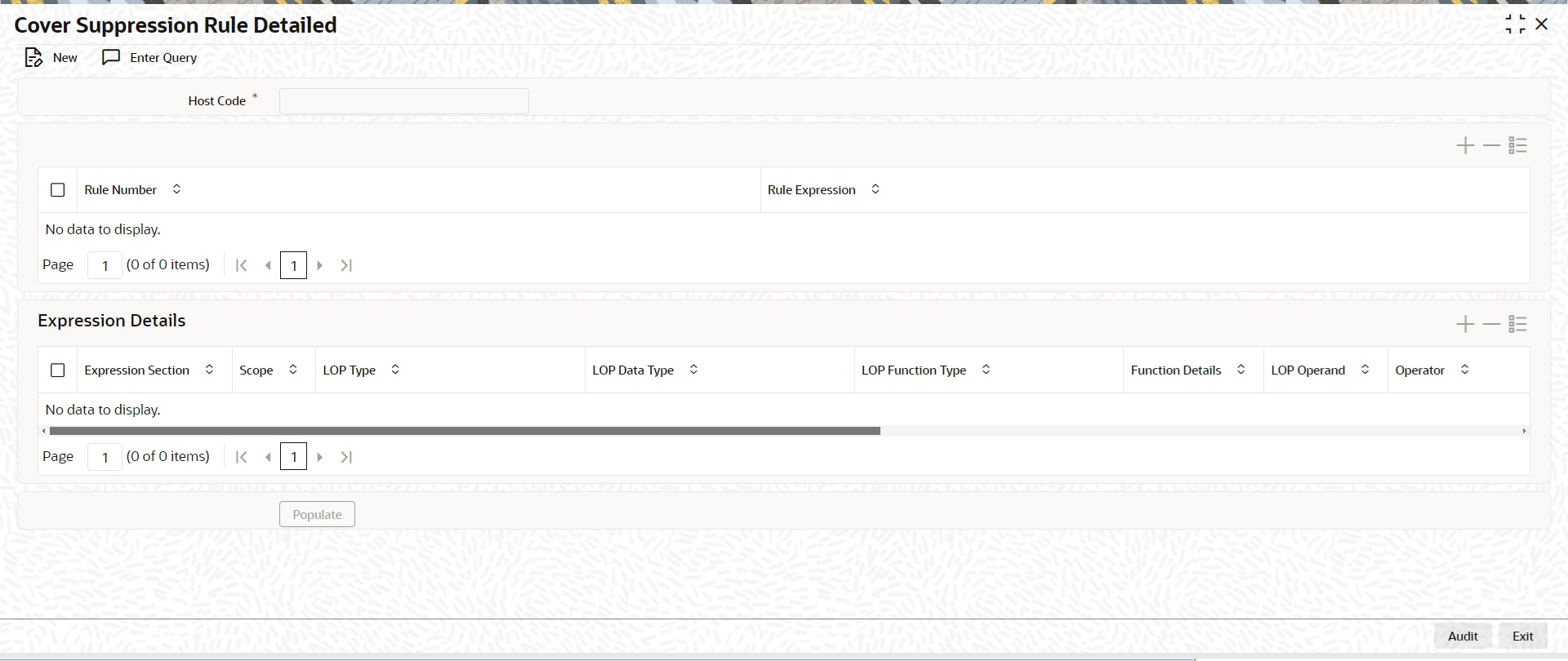

  1. On Homepage, specify PMDCSPRL in the text box, and click next arrow.
    Cover Suppression Rule Detailed screen is displayed.
    Figure 2-13 Cover Suppression Rule Detailed
  2. Click New button on the Application toolbar.
  3. On Cover Suppression Rule Detailed screen, specify the fields.
