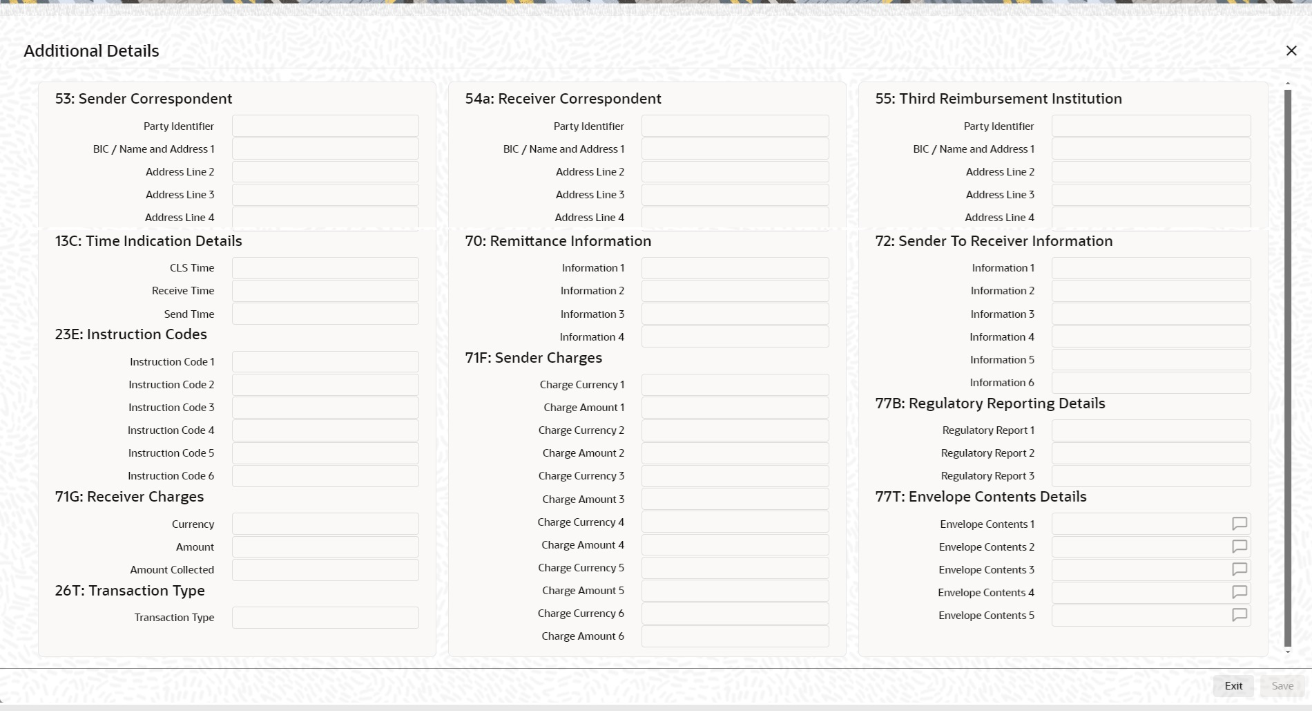

5.2.2.1 Additional Details
The Additional Details sub-screen allows users to capture additional information and view field values set by the system for the transaction.
  1. Click the Additional Details button at the bottom of the Inbound Swift Payments View screen.
    The Additional Details sub-screen is displayed.
    Figure 5-2 Inbound Swift Payments View_Additional Details
  2. On Additional Details button, specify the fields.
    For more information on fields, refer to the field description below:
    Table 5-2 Inbound Swift Payments View_Additional Details - Field Description
    Field Description
