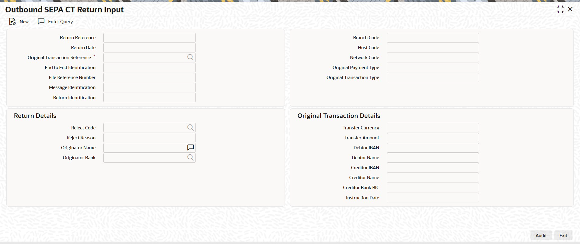

2.6.8 ACH Return Of Outbound Payment
- On Homepage, specify PADOTRTN in the text box, and click next
arrow.Outbound SEPA CT Return Input screen is displayed.
- Click New button on the Application toolbar.
- On Outbound SEPA CT Return Input screen, specify the fields.
For more information on fields, refer to the field description below:
Table 2-23 Outbound SEPA CT Return Input - Field Description
Field Description Return Reference Number System defaults the return reference number. Return Date System displays the Return Date as the current date by default. New System defaults the following on clicking ‘New’ button: - Return Date
