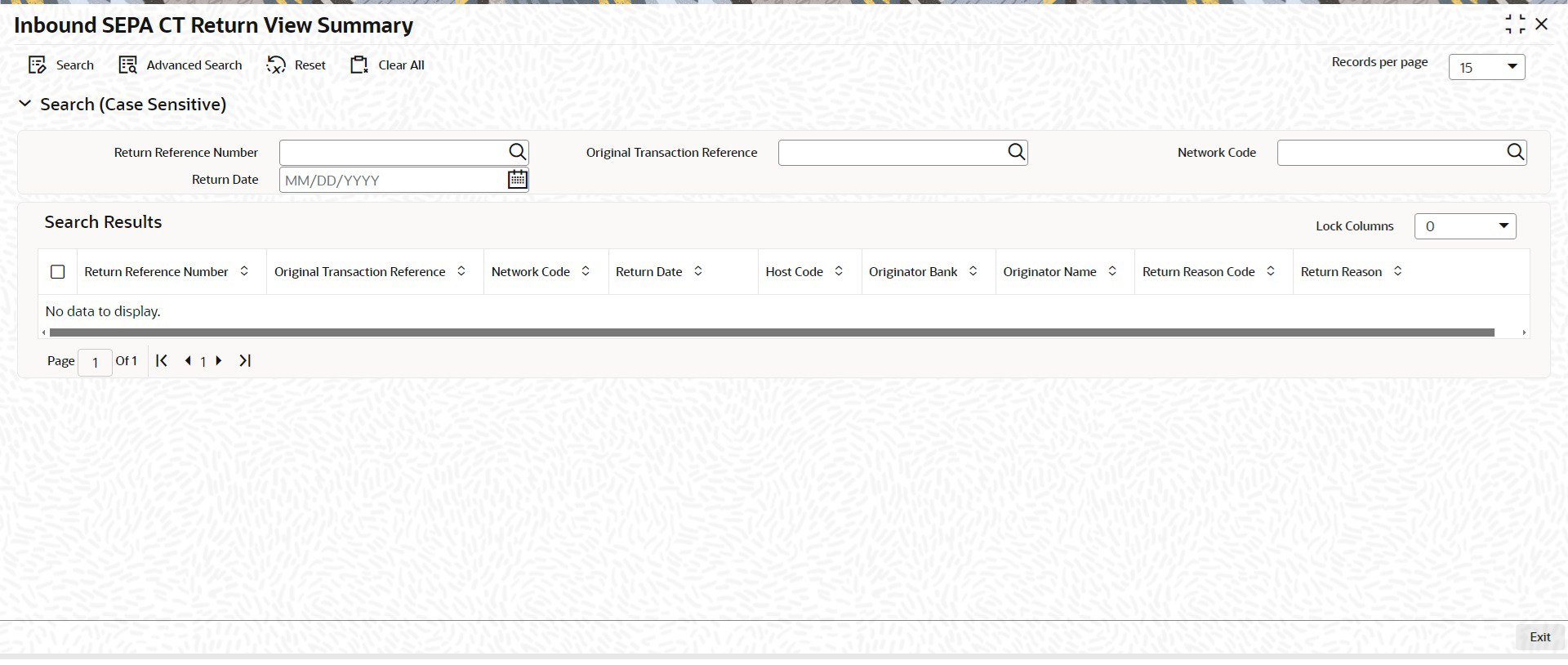

2.6.11.3 Inbound SEPA CT Return View Summary
  1. On Homepage, specify PASIRTVW in the text box, and click next arrow.
    Inbound SEPA CT Return View Summary screen is displayed.
    Figure 2-71 Inbound SEPA CT Return View Summary
    Description of Figure 2-71 follows
    Description of "Figure 2-71 Inbound SEPA CT Return View Summary"
  2. Search using one or more of the following parameters:
    • Return Reference Number
    • Original Transaction Reference
    • Network Code
    • Return Date
  3. Once you specified the parameters, click the Search button.
    System displays the records that match the search criteria.
