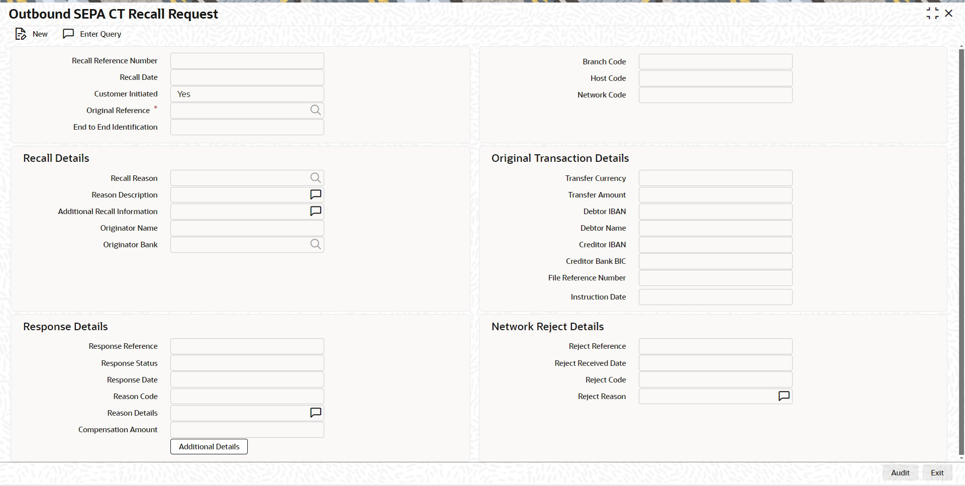

- On Homepage, specify PADOTRCL in the text box, and click next
arrow.Outbound SEPA CT Recall Request screen is displayed.
Figure 2-42 Outbound SEPA CT Recall Request
Description of "Figure 2-42 Outbound SEPA CT Recall Request" - Click New button on the Application toolbar.
- On Outbound SEPA CT Recall Request screen, specify the fields.
For more information on fields, refer to the field description below:
Table 2-19 Outbound SEPA CT Recall Request - Field Description
Field Description Recall Reference Number System defaults the recall reference number. Branch Code System defaults the branch code with the user’s logged in branch code. Recall Date Specifies the date on which the recall was initiated. This date is defaulted as recall booking date. Host Code System defaults the host code of transaction branch. Customer Initiated Specify if the customer initiated the recall. System defaults the Value as ‘Yes’. Original Reference Select the Original Payment Reference. All Outbound payments with payment type as ‘ACH’ and transaction status as ‘Processed’ or ‘Future Valued’ are listed for this field. On selecting the Original Reference, the information related to the transaction is defaulted in the below listed fields:

Recall Details -- Recall Reason While initiating a Recall request, you can specify the reason for the recall. All valid reject codes applicable for the Network for the operation ‘Payment Recall ‘are listed for this field. Reason Description Based on the Reason code selected, reason description is defaulted. Additional Recall Information If the reason code entered is ‘FRAD’ then you can provide additional details in this field. Originator Name Specifies the name of the Originator. Originator Bank Specifies the name of the Originator Bank. Note:
Either Originator name or Originator Bank code can be captured as part of recall requestResponse Details Response details are populated if a positive response is received from Beneficiary bank.
Response Reference Specifies the reference of the response. Response Status Specifies the status of the response. Response Date Specifies the date on which the response was created. Reason Code Specifies the reason code. Reason Details Specifies the reason for recall. Compensation Amount Specifies the compensation amount. Additional Details Click Additional Details button to view Additional information 1 to 13 for the recall response. The additional information is received from the beneficiary bank. Network Reject Details Network reject details are populated if the recall request sent is rejected by the CSM.
Reject Reference Specify the reference for rejection. Reject Received Date Specify the date on which the reject was received. Reject Code Specify the reject code. Reject Reason Specify the reason for rejection. - Sanction Scanning on Recall of Outbound Credit Transfers (camt.056
