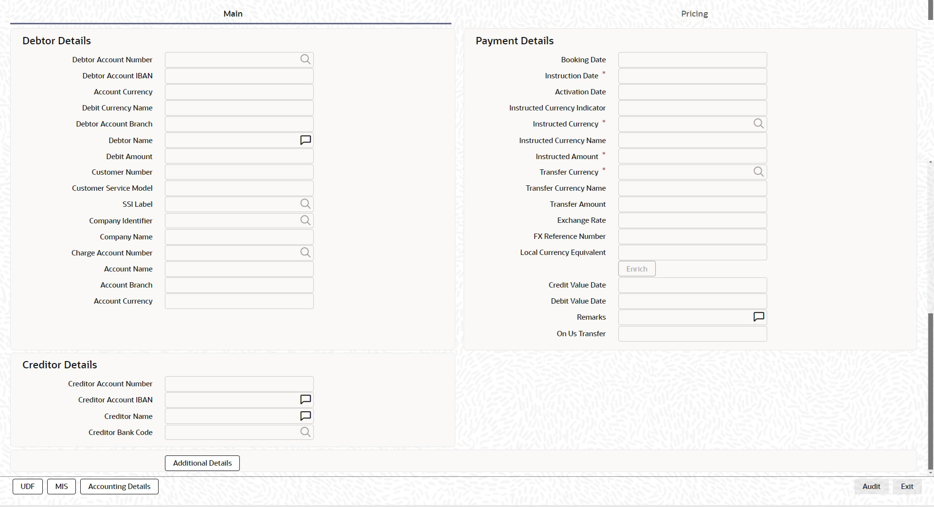

2.2.1.1 Main Tab
- Click on Main Tab in the ‘Outbound SEPA CT Transaction Input’ screen to
capture Creditor/ Debtor/ Payments details.
Figure 2-2 Outbound SEPA CT Transaction Input - Main Tab
Description of "Figure 2-2 Outbound SEPA CT Transaction Input - Main Tab" - Click New button on the Application toolbar.
- On Main tab, specify the fields.
For more information on fields, refer to the field description below:
Table 2-2 Outbound SEPA CT Transaction Input - Main Tab - Field Description
