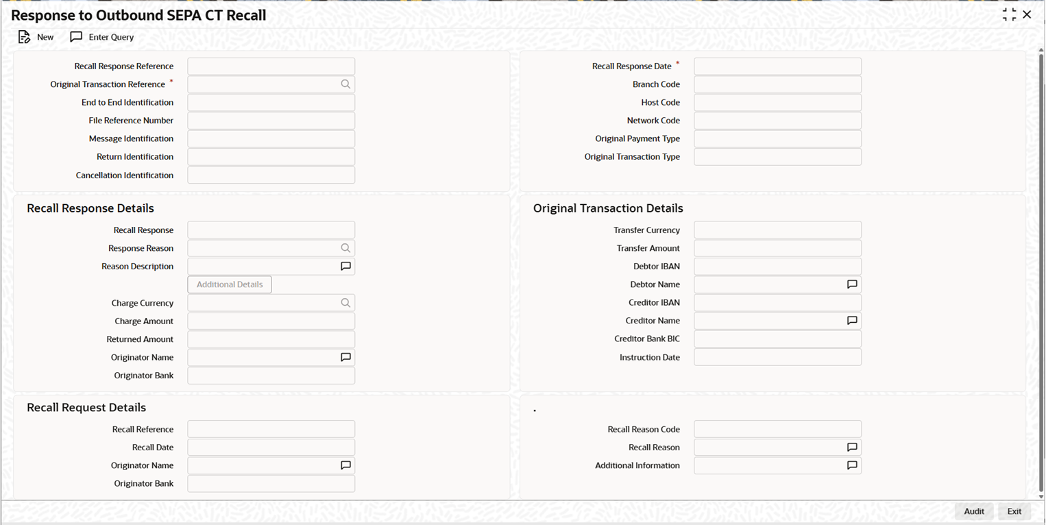

2.6.6 Response to Outbound SEPA CT Recall
- On Homepage, specify PADRCRES in the text box, and click next
arrow.Response to Outbound SEPA CT Recall screen is displayed.
Figure 2-56 Response to Outbound SEPA CT Recall
Description of "Figure 2-56 Response to Outbound SEPA CT Recall" - Click New button on the Application toolbar.
- On Response to Outbound SEPA CT Recall screen, specify the fields.
For more information on fields, refer to the field description below:
Table 2-21 Response to Outbound SEPA CT Recall - Field Description
