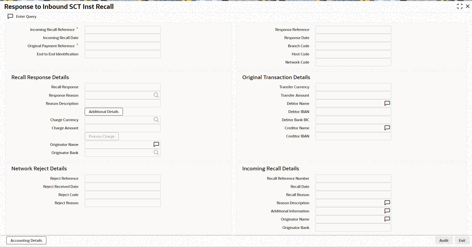

1.4.6 Response to Inbound SCT Inst Recall
- On Homepage, specify PFDITRCL in the text box, and click next
arrow.Response to Inbound SCT Inst Recall screen is displayed.
Figure 1-23 Response to Inbound SCT Inst Recall
Description of "Figure 1-23 Response to Inbound SCT Inst Recall" - Recall requests received by the Beneficiary Bank are available in this screen.
- On Response to Inbound SCT Inst Recall screen, you can query the records and provide positive/negative response to the Originating Bank.
- You can query the available records by providing the Inbound Recall reference
number.The following details are defaulted on clicking Execute Query button:

Table 1-12 Response to Inbound SCT Inst Recall - Field Description
Field Description Charge Amount If the recall request is accepted you can mention the charge amount applicable. This amount is reduced from the payment amount while returning the funds.
On clicking Process Charge button, the system defined charge is defaulted. The charge is populated based on the Recall Acceptance Price code maintenance for the transaction type ‘Inbound’ in Network Currency Preferences. You can override the defaulted charge.
Additional Details On clicking Additional Details button, you can invoke Additional Details button to specify Additional information 1 to 13 for the recall response. The number of “Additional Information” that can be entered changes based on the value of “Recall Response”, “Response Reason” and whether Recall or RFRO.
