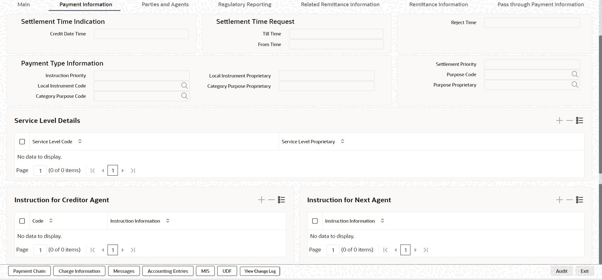

3.2.1.2 Payment Information Tab
  1. On Payment Information Tab, specify the fields.
    Figure 3-142 RTGS ISO Outbound FI to FI Customer Credit Transfer Input - Payment Information Tab
    Description of Figure 3-142 follows
    Description of "Figure 3-142 RTGS ISO Outbound FI to FI Customer Credit Transfer Input - Payment Information Tab"
    Table 3-36 RTGS ISO Outbound FI to FI Customer Credit Transfer Input_Payment Information Tab - Field Description
    Field Description
    Settlement Time Indication --
    Credit Date Time Specify Date and Time of crediting the transaction.
    For above mentioned fields, the time Off-Set is made mandatory for translation purposes.
    Settlement Time Request --
    From Time Specify the From Time.
    Till Time Specify the Till Time.
    Reject Time Specify the Reject Time.
    For the above mentioned fields, the time Off-Set is made mandatory for translation purposes.
    For Till Time and Reject Time, you should input the time value before the cutoff time for customer payments maintained in the Generic RTGS Network Preference Maintenance (PSDGRTNP) screen.
    For From Time, you should input the time value before the Till time or Reject time value.
    User can input either Till Time or Reject Time value but not both.
    Till Time or Reject Time value should be more than the current host date time if the Instruction date is today.
    Payment Type Information --
    Instruction Priority Specify Instruction Priority from following:
    • HIGH
    • NORM
    Local Instrument Proprietary Specify Local Instrument Code from the list of values. This list contains ISO 20022 Instrument codes.
    Settlement Priority Specify Settlement Priority from the following:
    • HIGH
    • NORM
    • URGT
    Local Instrument Code Specify Local Instrument Code from the list of values. This list contains ISO 20022 Instrument codes.
    Category Purpose Code Specify Category Purpose Code from the list of values. This list contains ISO 20022 Category Purpose codes.
    Purpose Code Specify Purpose Code from the list of values. This list contains ISO 20022 Purpose codes.
    Purpose Proprietary Specify the Purpose Proprietary value.
    Category Purpose Proprietary Specify the Category Purpose Proprietary value.
    If you specify Local Instrument, either you Code or Proprietary.
    If you specify Purpose, either you input Code or Proprietary.
    If you specify Category Purpose, either you Code or Proprietary.
    Service Level Details --
    Service Level Code Specify Service Level Code from the list of values. This list contains ISO 20022 Service Level codes.
    Service Level Proprietary Specify the Service Level Proprietary value.
    Only three occurrences of Service Level are allowed.
    If you input Service Level, either you Code or Proprietary.
    Instruction for Creditor Agent --
    Code Select Code from the following:
    • CHQB
    • HOLD
    • PHOB
    • TELB
    Instruction Information Specify the Instruction Information.
    Only two occurrences of Instruction For Creditor Agent are allowed.
    If you input Instruction For Creditor Agent, then you should input Code.
    If code CHQB is present, then code HOLD is not allowed, else HOLD is optional.
    If code PHOB is present, then code TELB is not allowed, else TELB is optional.
    You can use Instruction Information only when Code is PHOB to indicate the phone number.
    Instruction for Next Agent --
    Instruction Information Specify the Instruction Information to be given to the next agent in the payment chain.
    Only six occurrences of Instruction For Next Agent are allowed.
