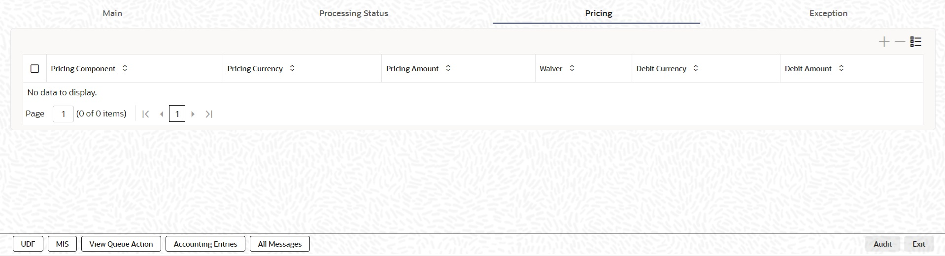

1.3.2.4 Pricing Tab
  1. You can view the charge amount computed by the system for each of the Pricing components of the Pricing code linked to the network code of the transaction.
  2. For the Transaction initiated, system displays the fees/tax charged in this tab. Click the “Pricing” tab.
  3. On Pricing Tab, specify the fields.
    Figure 1-24 HKFPS Outbound Credit Transfer Transaction View - Pricing Tab
    Description of Figure 1-24 follows
    Description of "Figure 1-24 HKFPS Outbound Credit Transfer Transaction View - Pricing Tab"
    Table 1-16 HKFPS Outbound Credit Transfer Transaction View_Pricing Tab - Field Description
    Field Description
    Pricing Component System displays each Pricing component of the Pricing code from the Pricing Code Maintenance.
    Pricing Currency System displays the Pricing currency of each Pricing component of the Pricing code.
    Pricing Amount System displays the calculated Charge amount for each Pricing component of the Pricing code.
    Waived System displays if charges for any Pricing component are waived in the Pricing maintenance.
    Debit Currency System displays the currency of the Charge account to be debited for the charges.
    Debit Amount System displays the Charge amount for each Pricing component debited to the charge account in Debit currency. If the Pricing currency is different from the Debit currency the calculated charges are converted to the Debit currency and populated in this field.
