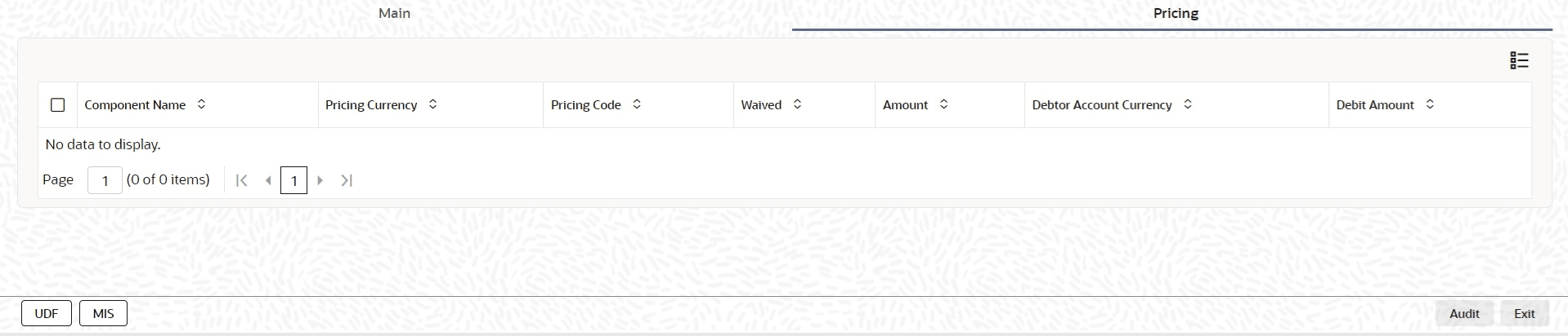

2.2.1.2 Pricing Tab
- Click the Pricing tab and view the pricing details.
Figure 2-23 Instrument Issue - Pricing Tab
Description of "Figure 2-23 Instrument Issue - Pricing Tab" - On Pricing screen, the computed charges, and taxes if applicable, are populated for each charge component in the following fields.
On clicking the Enrich button, system would compute the Charges, and Tax on Charges if applicable, based on the maintenance for Pricing Code specified in Instrument Preferences (PIDINPRF).
There may be one or more applicable Charge and Tax components as defined in the Pricing Code maintenance. For each Charge and/or Tax component, the fixed amount or rate would be fetched from Pricing Value Maintenance screen (PPDVLMNT).
