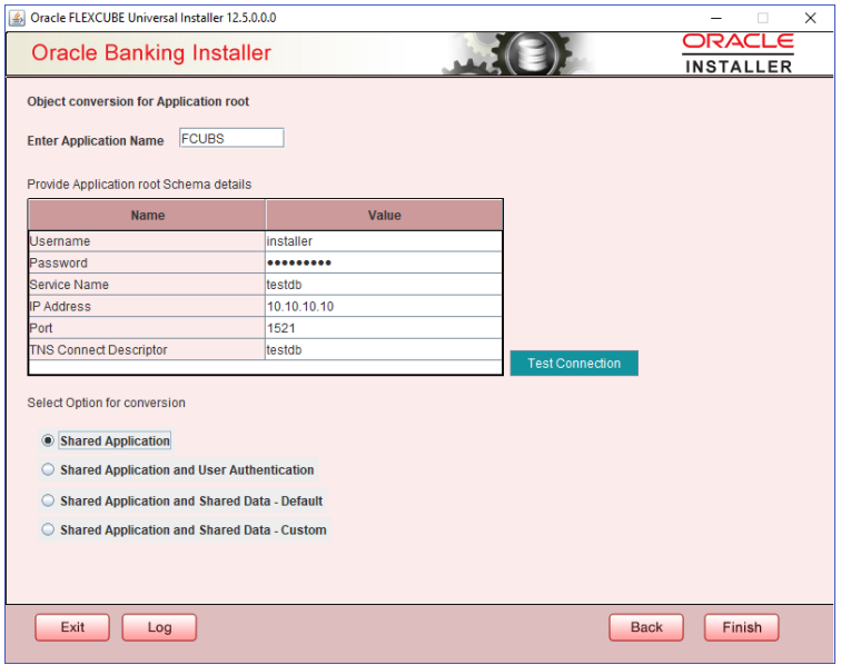

  3. In the Approot object conversion screen, enter Application name and the Application root schema details where the conversion has to be applied and click on ‘Test Connection’.
  4. Once the Connection is successful, ‘Finish’ button will be enabled.
  5. User has to select the option Shared Application and click on the ‘Finish’ button to complete object conversion.
    Figure 5-4 Object Conversion for Application Root

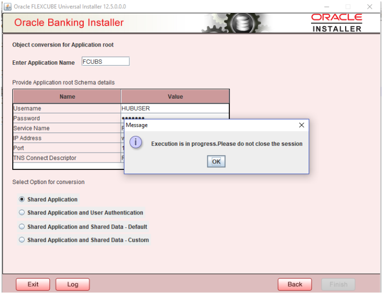

  6. Execution will take few minutes and post completion, a dialog box displays ‘Compilation Success’ message in the front end.
    Figure 5-5 Object Conversion for Application Root
