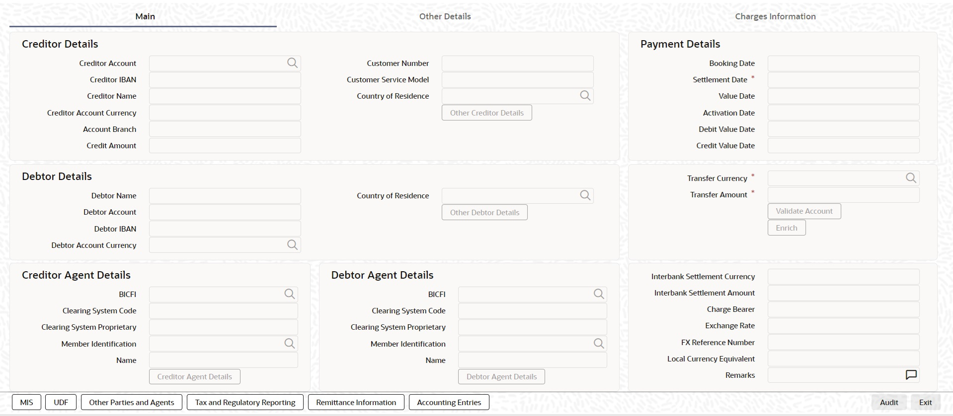

2.5.2.1 Main Tab
  1. Click on Main tab on the ACH Credit Transfer Receipts Input screen.
    Main Tab sub-screen is displayed.
    Figure 2-56 ACH Credit Transfer Receipts Input - Main Tab
    Description of Figure 2-56 follows
    Description of "Figure 2-56 ACH Credit Transfer Receipts Input - Main Tab"
  2. On Main Tab sub-screen, specify the fields.
    For more information on fields, refer to the field description below:
