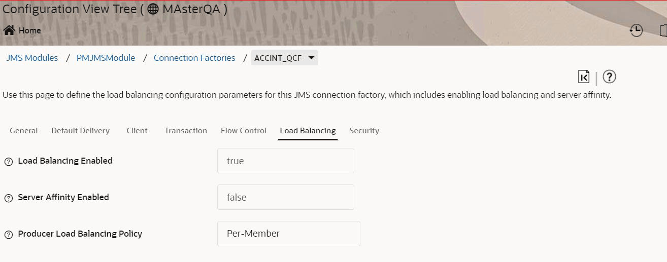

- JMS Load Balancing Configuration
Configuration -> Services -> JMS Modules -> Connection Factories For each of the Distributed Queue Connection Factory, set the “Server Affinity” to false . This ensures that the messages get distributed uniformly across all the managed servers in a cluster.

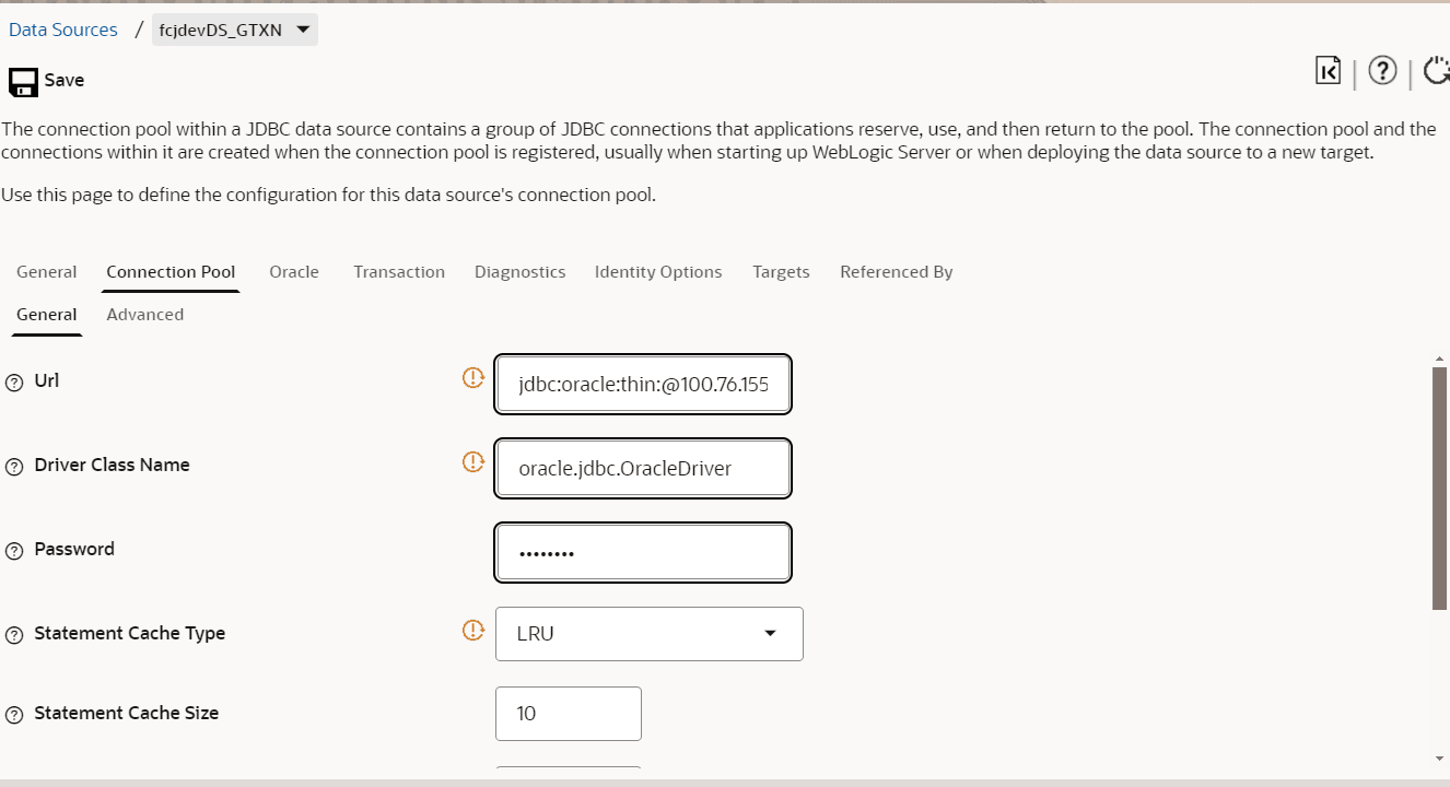

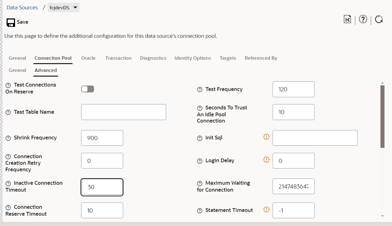

- Non Transactional Datasource Configuration
Datasource which do not have the “Supports Global Transactions” flag enabled are referred as Non-Transactional Datasource, as they do not come under the Container/Server managed transactions.
Figure 2-2 Settings for jbdc/fcjdevDS
For such Datasources, the inactive connection timeout seconds must be configured to a positive value. This helps to avoid the Connection Leak scenario. The suggested value is 30 seconds.

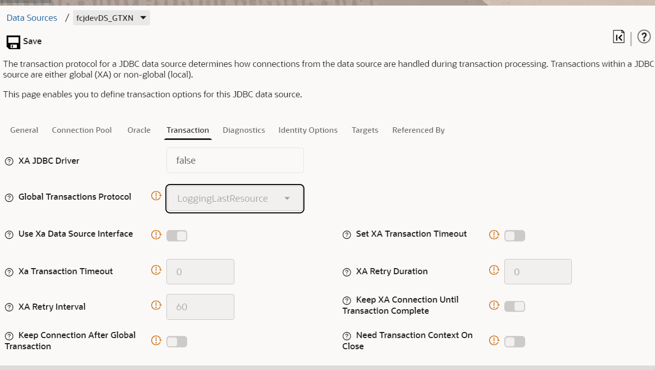

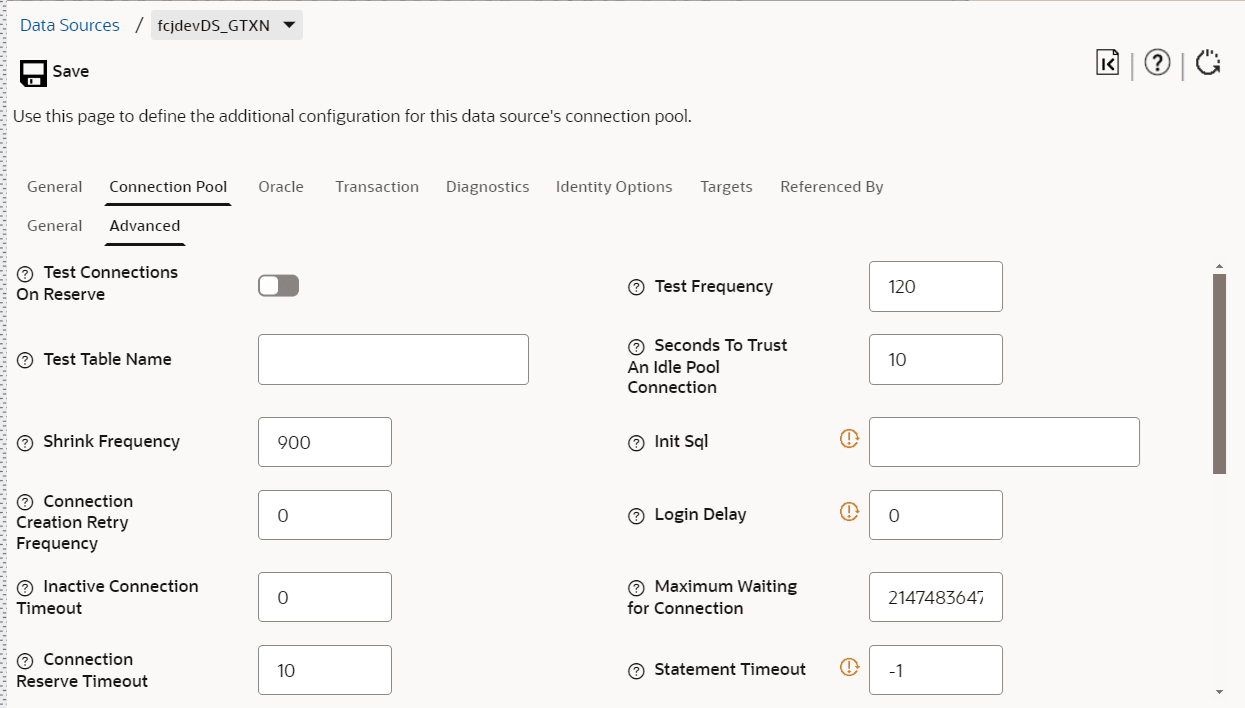

- Transactional Datasources Configuration
Datasource for which the “Global Transactions Protocal” is enabled referred as Transactional Datasource, as they come under the Container/Server managed transactions.

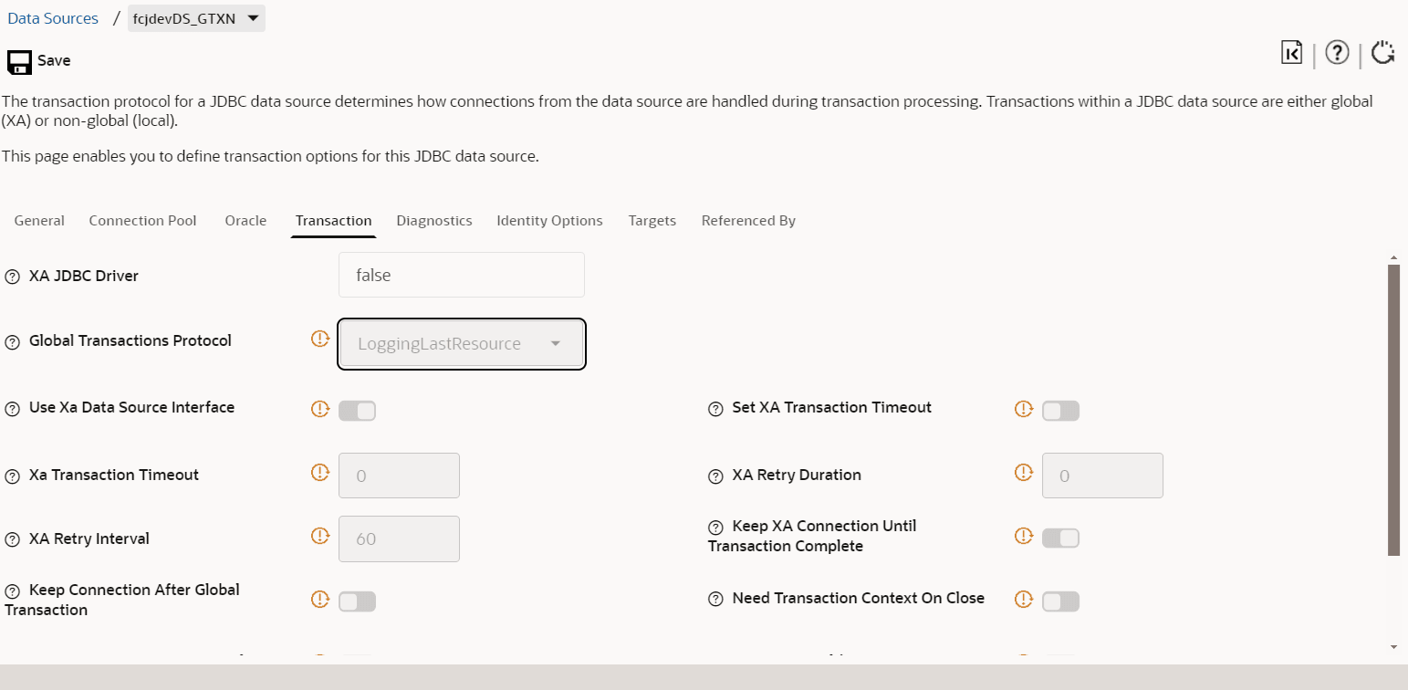

Figure 2-4 Settings for jbdc-fcjdevDS_GTXN
For such data sources ensure that “Logging Last Resource” option is selected.
Figure 2-5 Settings for jbdc-fcjdevDS_GTXN
Set “Inactive Connection Timeout” seconds to 0. For the transactional Datasources as they participate in the container transaction, the timeout is governed by the JTA timeout seconds.

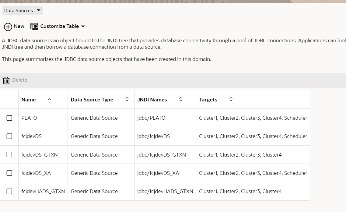

- Data Source Setup Verification
- Navigate to the Data Sources Configuration
- Below Data Sources must be mapped in the Data Sources Configuration
- Jdbc/fcjdevDS
- Jdbc/fcjdevDS_GTXN
- Jdbc/fcjdevDS_XA
- Additional Data Sources for Co-deployed
- jdbc/fcjdevDS_ASYNC
- Below listed Data Sources must be configured as NXA (Please refer to the
below screen-shot for Jdbc/fcjdevDS_GTXN)
- Jdbc/fcjdevDS
- Jdbc/fcjdevDS_ASYNC
- Below listed Data Sources must be configured as XA
- Jdbc/fcjdevDS_XA
- Below options must be enabled for the GTXN Data Source -
Jdbc/fcjdevDS_GTXN
- Supports Global transactions
- Logging Last Resource
During creation of this datasource a table will be created in the connected database with the table name as WL_LLR_||’managed_server_name'
Here the managed server will be the name of the target server associated with the datasource.
For JDBC LLR 2PC transactions, if the transaction data is too large to fit in the LLR table, the transaction will fail with a rollback exception during commit. This can occur if your application adds many transaction properties during transaction processing. In this case, the database administrator can drop the existing table and create a new LLR table with the same name or alter the column with larger recSize value for RECORDSTR data column. The RECORDSTR data column must be the DBMS's variable string column type with the DBMS's maximum size. In this way, the DBMS allocates as much space as the data needs for a given row.
- Target Server for Datasources created
- If Payments WAR is deployed with embedded Scheduler, all datasources should point to the single Managed Server, where the application is deployed.
- If Payments WAR and Scheduler WAR are deployed on two different
servers.
- Below datasources should be targeted to Managed Server where
jdbc/fcjdevDS
jdbc/fcjdevDS_GTXN
jdbc/fcjdevDS_XA
Scheduler is deployed.
jdbc/fcjdevDS
jdbc/fcjdevDS_XA

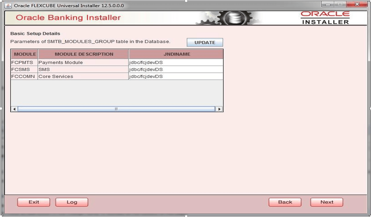

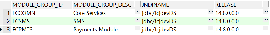

- Verifying data in SMTB_MODULES_GROUP Table
- JNDI Names Input during Installation process must be verified with records in the SMTB_MODULES_GROUP table.
- JNDI name provided here should be created on console.
Figure 2-9 Below is the screen-shot of Data Input during installation
Description of "Figure 2-9 Below is the screen-shot of Data Input during installation"Figure 2-10 Below is the screen-shot of records in the SMTB_MODULES_GROUP table
