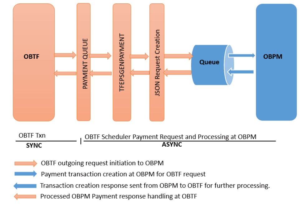

  • ASYNC Processing,
    • In OBTF a transaction is created with payment message initiation to OBPM system.
    • TFEPSGENPAYMENT scheduler fetches records from Queue and handovers to OBPM.
    • In OBPM a transaction is created and response is sent to OBTF
    • OBTF updates the queue references accordingly.
Figure 2-8 OBTF Outgoing Payment Request

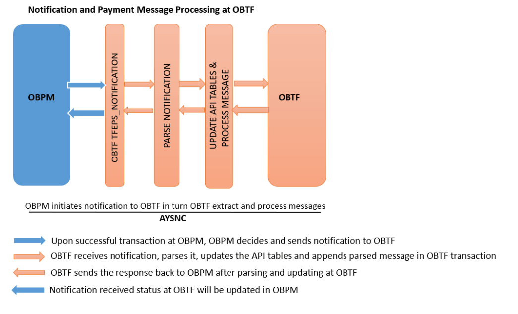

  • Upon successful transaction creation at OBPM, OBPM decides in sending notification to OBTF.
  • Once OBTF receives notification, OBTF parses notification, extracts payment message and updates the message CLOB of the OBTF transaction.
  • Upon notification updated at OBTF, OBPM receives the OBTF processed status and updates the external system (OBTF) processed status at OBPM.
Figure 2-9 Notification and Payment Message Processing at OBTF
