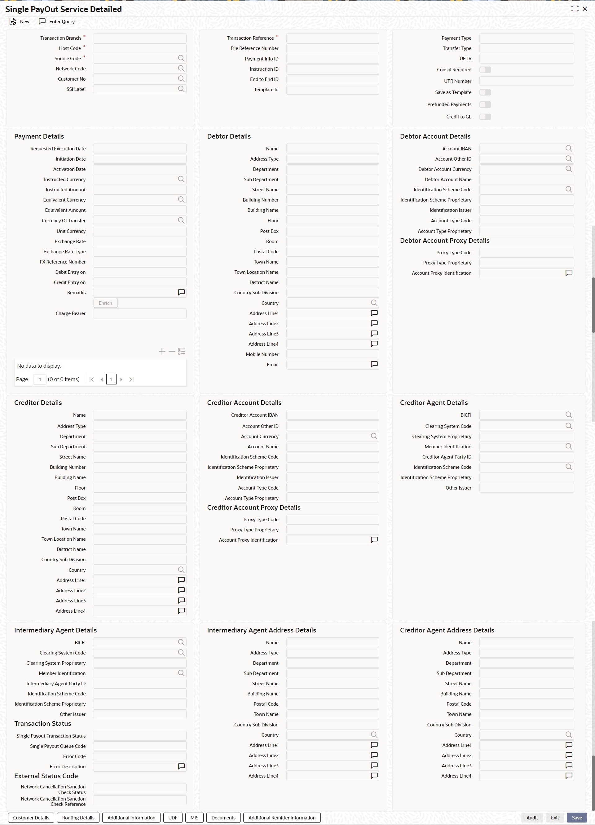

3.8.1 Single Payout Service
Single Payout Service Screen allows payment request input for single transaction. In this screen, user can accept single payout requests irrespective of the payment type.
- On Homepage, specify PMDPNSPS in the text box, and click next
arrow.Single Payout Service screen is displayed.
- Click New button on the Application toolbar.
- On Single Payout Service screen, specify the fields.For more information about the fields, refer to field description below:
Table 3-20 Single Payout Service - Field Description
Field Description Transaction Branch System defaults the Transaction Branch of transaction branch on clicking ‘New’. Host Code System defaults the Host Code of transaction branch on clicking ‘New’. Source Code Specify the Source Code from the list of values. Transaction Reference System populates a 16 digit transaction number . Network Code Specify the Network Code. Alternatively, user can select the Network Code from the option list. The list displays all valid network codes maintained in the system.

Account Type Proprietary Specify the Account Type Proprietary. Charge Account Number Specify the Charge Account Number from the list of values. Charge Account Branch Debtor account branch is displayed based on the Debtor account number selected. Charge Account Currency Specify the Charge Account Currency. Charge Account IBAN Specify the Charge Account IBAN. Creditor Details Specify Creditor Details fields, The Creditor Details fields are similar to the fields available in Section , "Debtor Details" field.
Creditor Account Details Specify Creditor Account Details fields, The Creditor Account Details fields are similar to the fields available in Section , "Debtor Account Details" field.
Creditor Agent Details -- BICFI Specify Creditor Agent BIC. Alternatively, you can select the BIC from the option list. The list displays all valid BIC codes maintained in the system. Clearing system Code Specify the Clearing system Code from the list of values. Clearing System Proprietary Specify the Clearing System Proprietary. Member Identification Specify the Member Identification. Alternatively, you can select the Member Identification from the option list. The list displays all valid bank codes maintained in the Local Bank directory system. Creditor Agent Party ID Specify the Creditor Agent Party ID. Identification Scheme Code Specify the Identification Scheme Code. Identification Scheme Proprietary Specify the Identification Scheme Proprietary. Other Issuer Specify the Other Issuer. Intermediary Agent Details Specify Intermediary Agent Details fields, The Intermediary Agent Details fields are similar to the fields available in Section , "Creditor Agent Details" field.
Intermediary Agent Address Details Specify Intermediary Agent Address Details fields, The Intermediary Agent Address Details fields are similar to the fields available in Section , "Debtor Details" field.
Creditor Agent Address Details Specify Intermediary Agent Address Details fields, The Intermediary Agent Address Details fields are similar to the fields available in Section , "Debtor Details" field.
