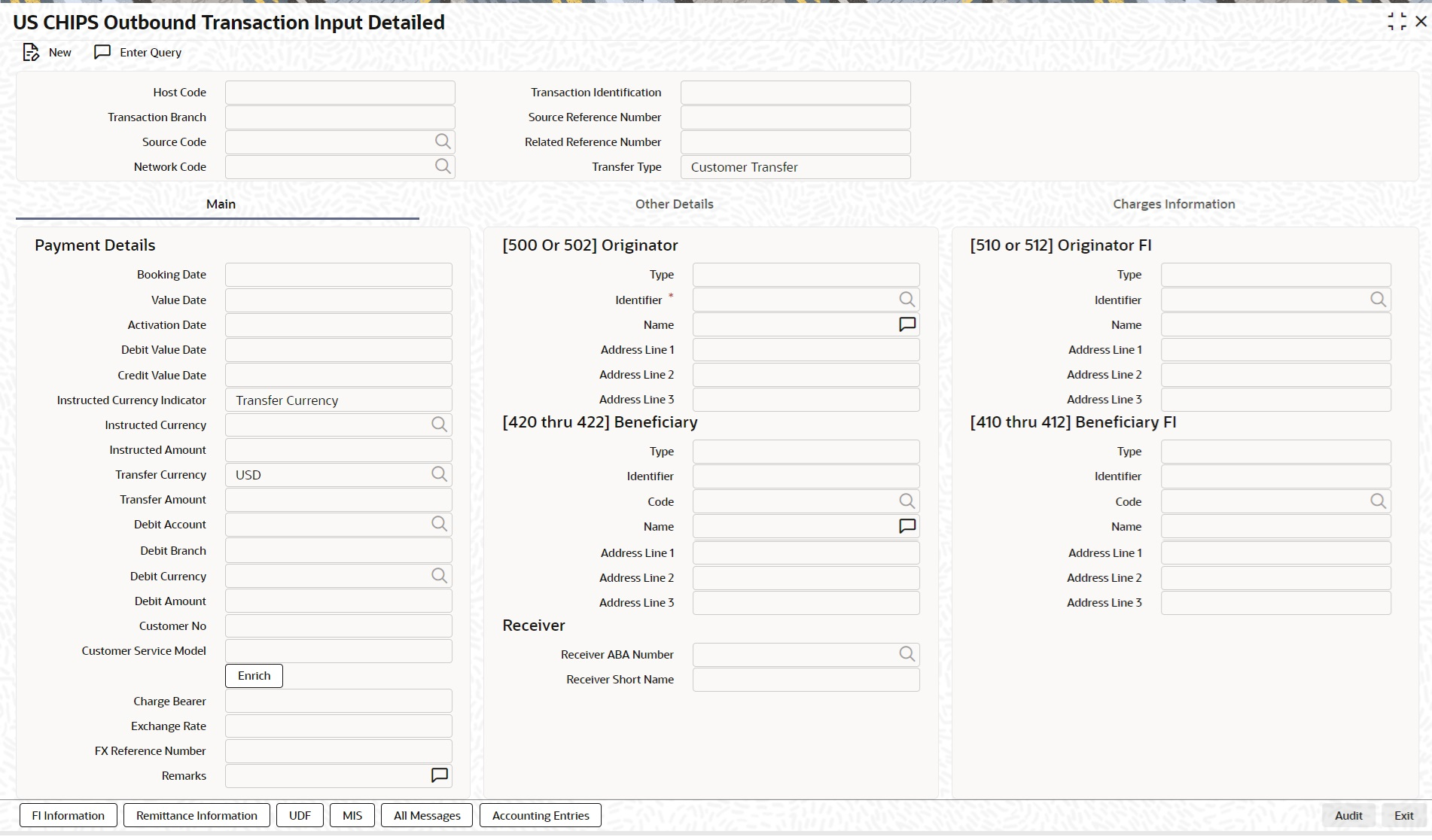

1.4.1.1 Main Tab
- On Main Tab, specify the fields.Figure 1-23 US CHIPS Inbound Transaction Input - Main Tab
 Description of "Figure 1-23 US CHIPS Inbound Transaction Input - Main Tab"Table 1-11 US CHIPS Inbound Transaction Input - Main Tab - Field Description Field Description Payment Details -- Booking Date System defaults to Current Branch Date. Value Date System defaults to Current Branch Date. Activation Date System defaults to Current Branch Date. Debit Value Date Specify the Debit Entry Value date. Credit Value Date Specify the Credit Entry Value date. Transfer Currency Specify the Transfer Currency from the list of values. System defaults to currency code value as USD. Transfer Amount Specify the Transfer amount. Creditor Account Number Specify the Credit Account Number from the list of values. Lists all valid [Open/Authorized] defined in the host - External Customer Account (STDCRACC). Credit Account Branch System defaults the Branch Code of the debit account selected. Credit Account Currency System defaults the Currency of the debit account selected. Credit Amount Specify the Credit Amount. Customer Number Specify the Customer Number from displayed resolved customer number. Customer Service Model Specify the Customer Service model of the resolved customer. Exchange Rate Specify the Exchange Rate, if Debit account currency is different from Transfer currency or Instructed Currency is different from Transfer Currency. FX Reference Number Specify the FX Reference Number. Remarks Specify the Remarks, if any. [500 OR 502] Originator -- Type Select the Identifier Type from the following: - UID
