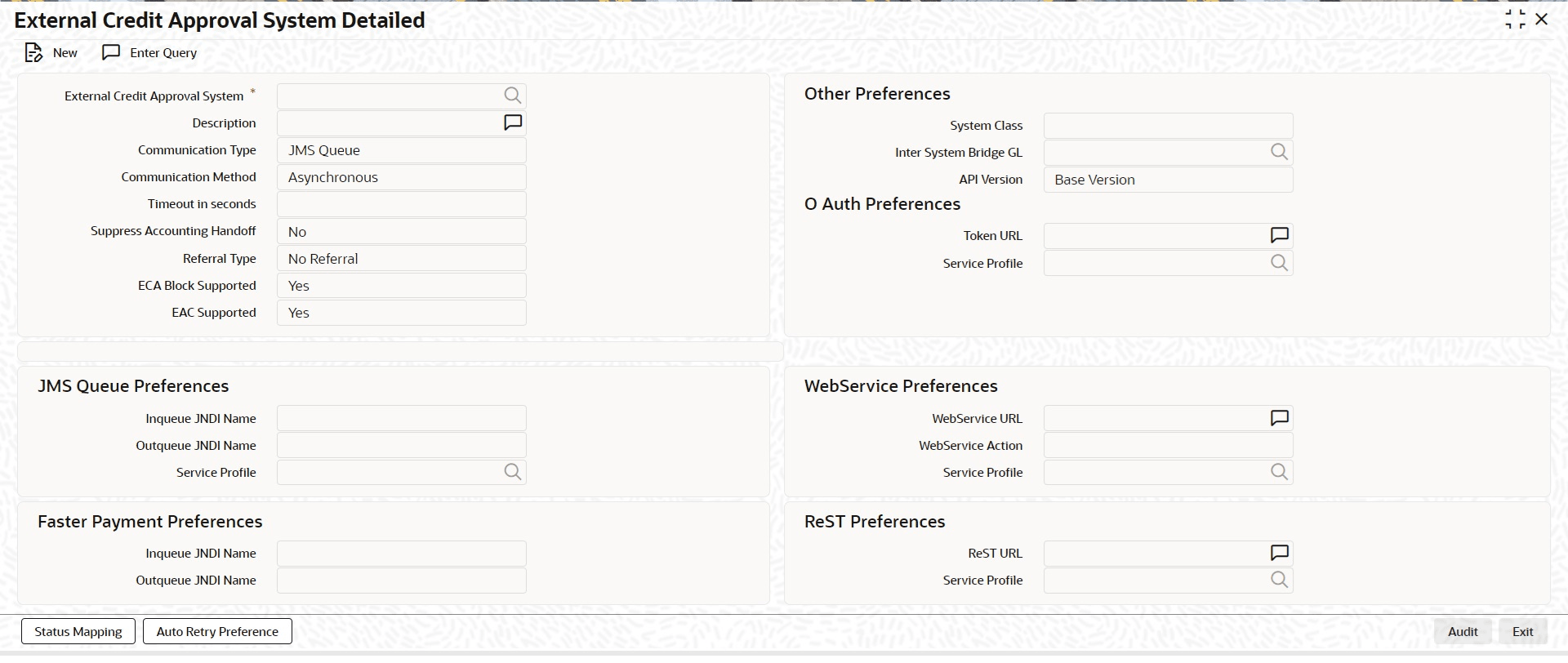

Map the ECA system ‘FCUBS’ in the PMDECAMT.
Figure 1-15 External Credit Approval System Detailed
Description of Figure 1-15 follows
Description of "Figure 1-15 External Credit Approval System Detailed"

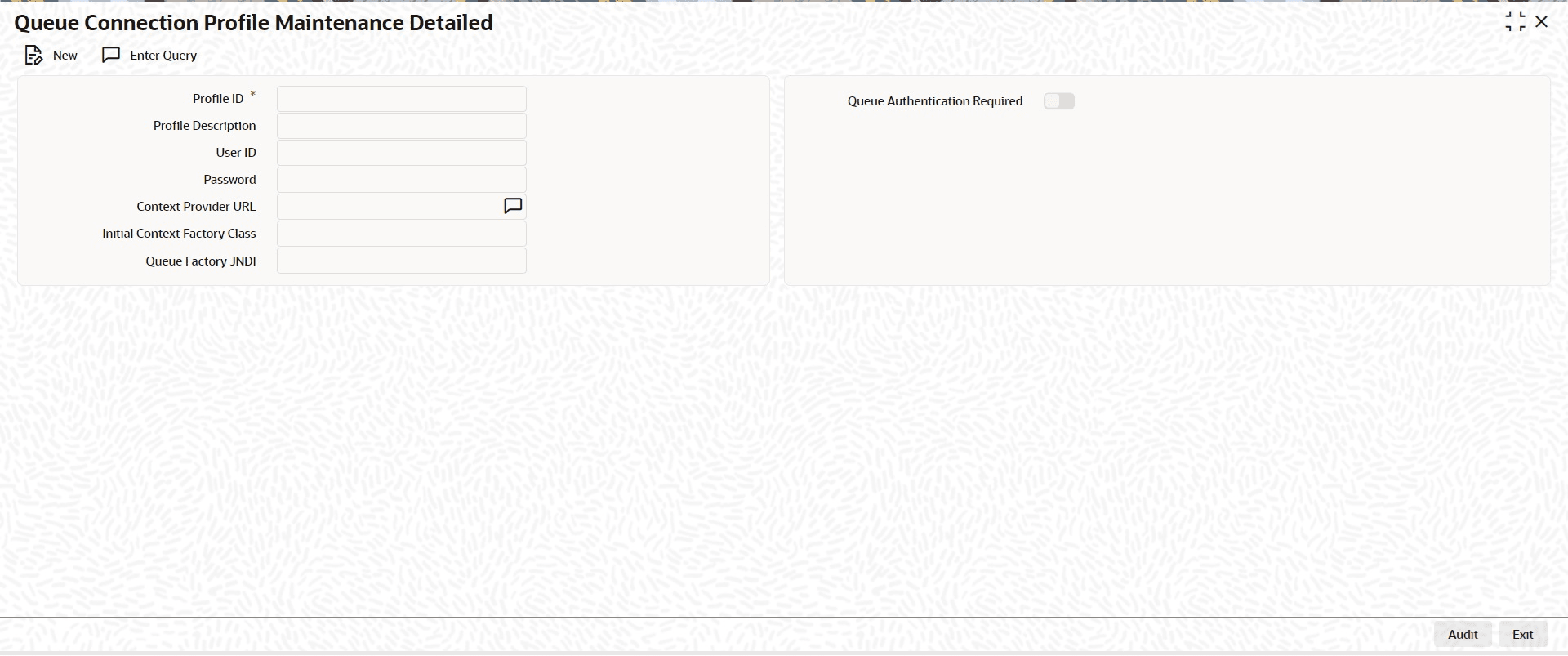

Maintain the In queue JNDI Name as MDB_QUEUE_RESPONSE, Outqueue JNDI Name as MDB_QUEUE & Q Profile – as per the MDB Queue created on the App Server as in Section 2.2. Q Profile should be the IP Address where the JMS Queue has been created. The OBPM System will post the ECA request to UBS via these MDB queues. Maintain Queue Profile in ‘PMDQPROF’.
Figure 1-16 Queue Connection Profile
Description of Figure 1-16 follows
Description of "Figure 1-16 Queue Connection Profile"
Queue profile requires the context provider URL of the Application Server where the queue is created. All other parameters are same as mentioned above.
