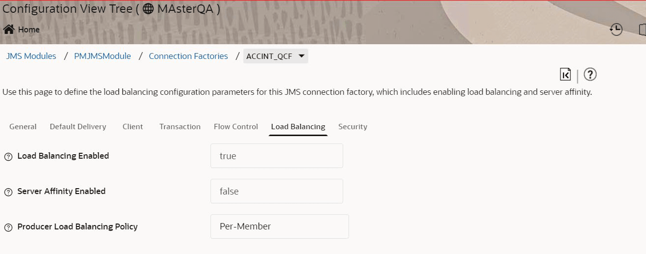

  3. JMS Load Balancing Configuration
    Configuration -> Services -> JMS Modules -> Connection Factories For each of the Distributed Queue Connection Factory, set the “Server Affinity” to false . This ensures that the messages get distributed uniformly across all the managed servers in a cluster.

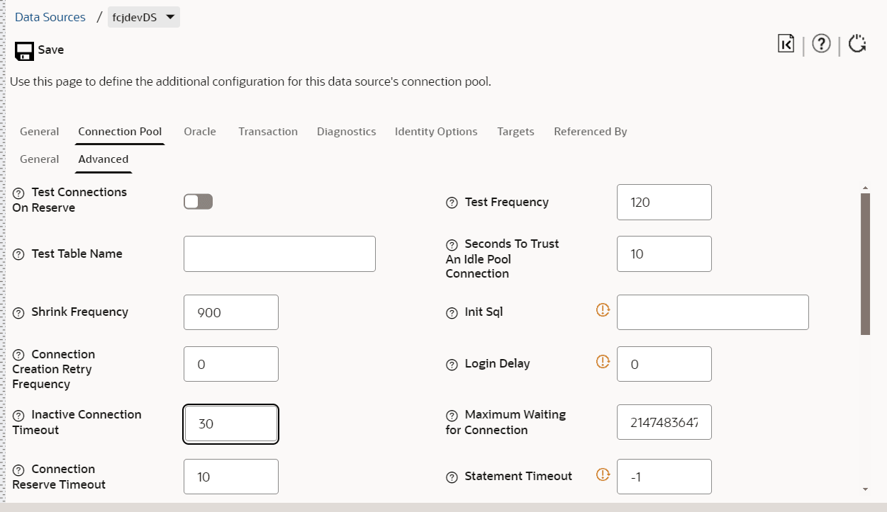

    For such Datasources, the inactive connection timeout seconds must be configured to a positive value. This helps to avoid the Connection Leak scenario. The suggested value is 30 seconds.
    Figure 1-3 Settings for jbdc/fcjdevDS

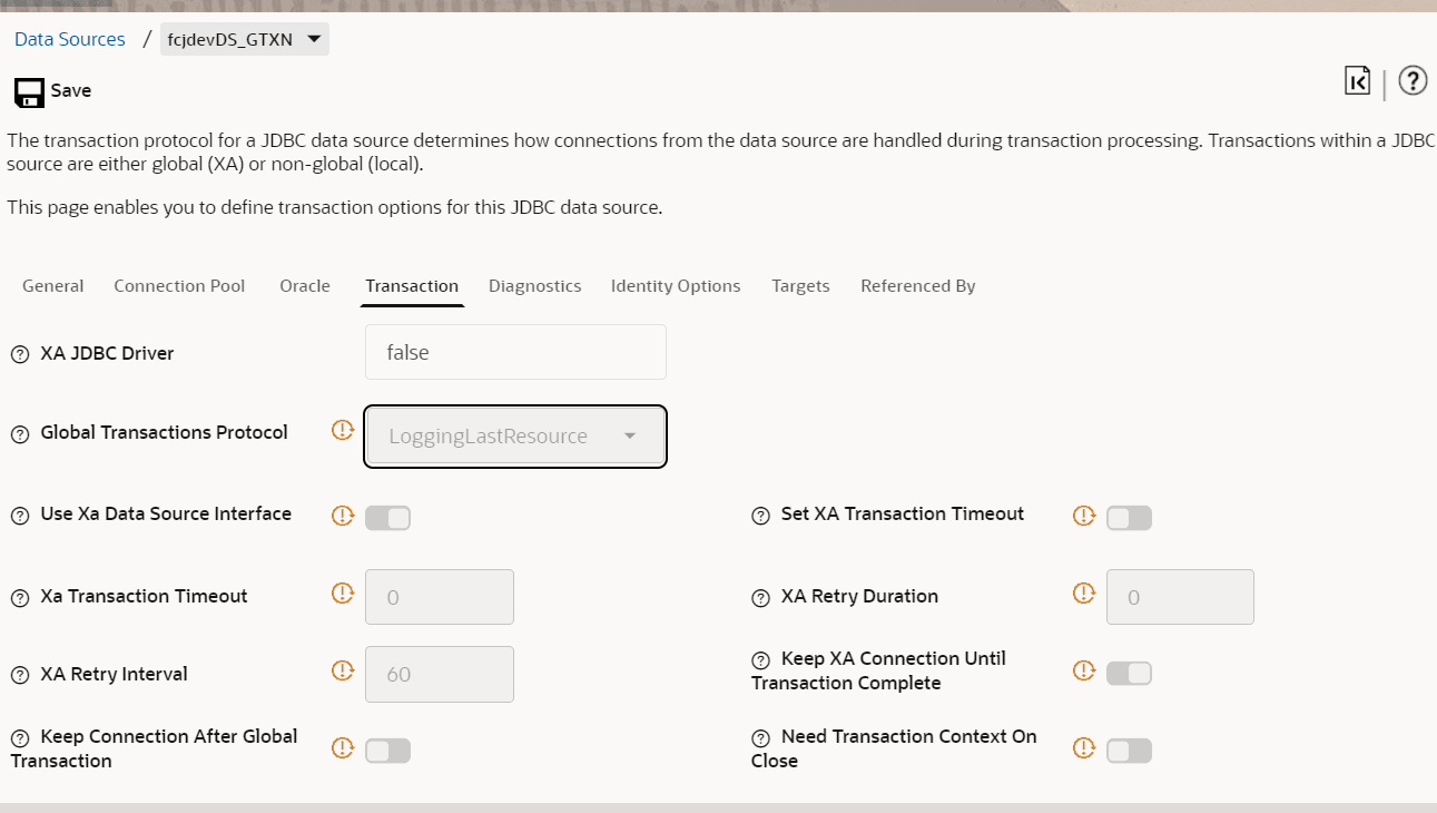

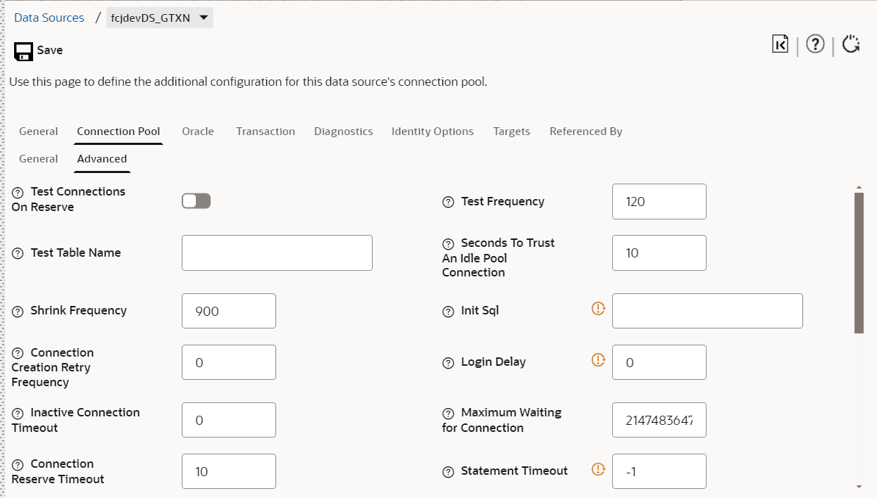

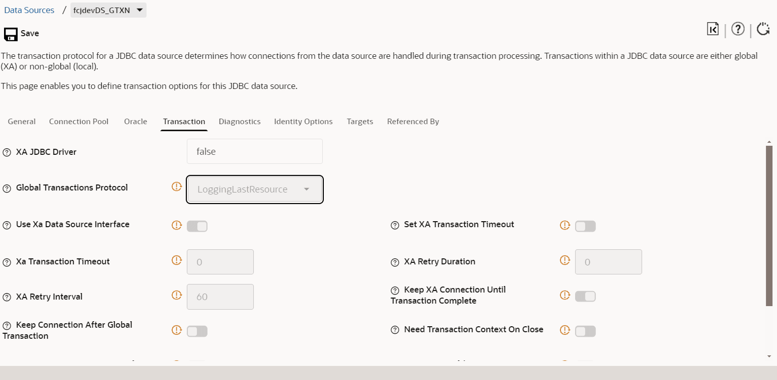

  5. Transactional Datasources Configuration
    Datasource for which the “Global Transactions Protocal” is enabled referred as Transactional Datasource, as they come under the Container/Server managed transactions.
    Figure 1-4 Settings for jbdc-fcjdevDS_GTXN
    For such data sources ensure that “Logging Last Resource” option is selected.
    Figure 1-5 Settings for jbdc-fcjdevDS_GTXN
    Set “Inactive Connection Timeout” seconds to 0. For the transactional Datasources as they participate in the container transaction, the timeout is governed by the JTA timeout seconds.

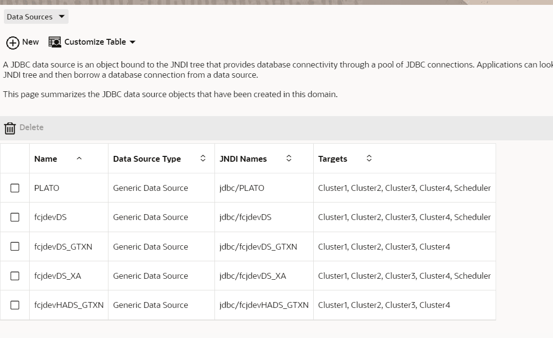

  6. Data Source Setup Verification
    1. Navigate to the Data Sources Configuration
    2. Below Data Sources must be mapped in the Data Sources Configuration
      1. Jdbc/fcjdevDS
      2. Jdbc/fcjdevDS_GTXN
      3. Jdbc/fcjdevDS_XA
    3. Additional Data Sources for Co-deployed
      1. jdbc/fcjdevDS_ASYNC

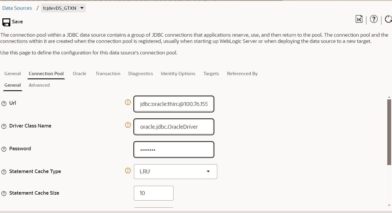

    4. Below listed Data Sources must be configured as NXA (Please refer to the below screen-shot for Jdbc/fcjdevDS_GTXN)
      1. Jdbc/fcjdevDS
      3. Jdbc/fcjdevDS_ASYNC
    5. Below listed Data Sources must be configured as XA
      1. Jdbc/fcjdevDS_XA
    6. Below options must be enabled for the GTXN Data Source - Jdbc/fcjdevDS_GTXN
      1. Supports Global transactions
      2. Logging Last Resource
      During creation of this datasource a table will be created in the connected database with the table name as WL_LLR_||’managed_server_name'
      Here the managed server will be the name of the target server associated with the datasource.

  7. Target Server for Datasources created
    1. If Payments WAR is deployed with embedded Scheduler, all datasources should point to the single Managed Server, where the application is deployed.
    2. If Payments WAR and Scheduler WAR are deployed on two different servers.
      1. Below datasources should be targeted to Managed Server where application is deployed.
        jdbc/fcjdevDS
        jdbc/fcjdevDS_GTXN
        jdbc/fcjdevDS_XA
      2. Below datasources should be targeted to Managed Server where Scheduler is deployed.
        jdbc/fcjdevDS
        jdbc/fcjdevDS_XA

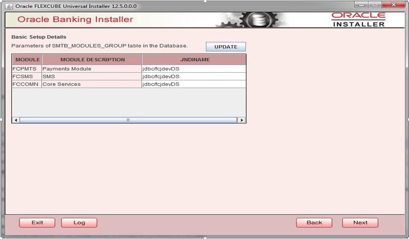

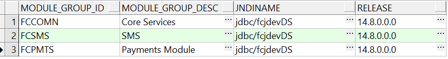

  8. Verifying data in SMTB_MODULES_GROUP Table
    1. JNDI Names Input during Installation process must be verified with records in the SMTB_MODULES_GROUP table.
    2. JNDI name provided here should be created on console.
    Figure 1-9 Below is the screen-shot of Data Input during installation

    Figure 1-10 Below is the screen-shot of records in the SMTB_MODULES_GROUP table
