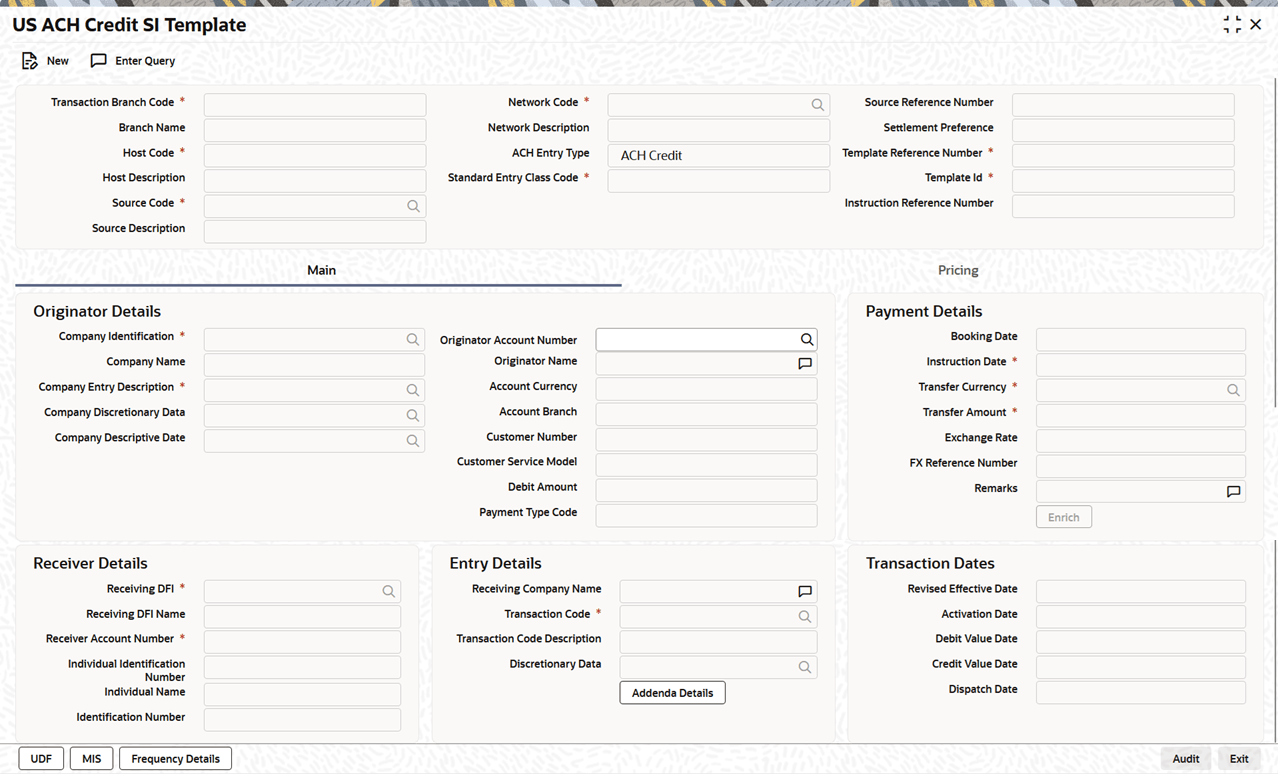

This topic explains the Main tab of the US ACH Credit SI Template screen.
  1. Select the Main tab in the main screen.
    The Main details are displayed.
    Figure 1-63 US ACH Credit SI Template_Main Tab
  2. On Main tab, specify the fields.
    For more information about the fields, refer to field description table.

    Field Description
    Originator Details This section displays the Originator Details.
    Company ID Specify the Company ID of the originator from list of values that fetches company Id records from the existing Originator Maintenance Detailed (PMDORGDT).
    Company Name This field is auto-populated from the Company Identification Maintenance based on the company Id.
    Company Entry Description Specify the Company Entry Description. This field captures the purpose of the transaction and will have a LOV enabling the user to search and select a previously entered text or enter a new value during manual booking.
    Company Discretionary Data Specify the Company Discretionary Data from the list of values. It allows the user to search and select a previously entered text or enter a new value. The LOV functions in the same way as the Company Entry Description field described above.
    Company Descriptive Date Specify the Company Descriptive Date from the list of values.
    Originator Account Number Specify the Originator Account Number from the list of values.
    Originator Name System defaults the originator name upon selecting the account number.
    Account Currency System defaults the account currency upon selecting the account number.
    Account Branch System defaults the account branch upon selecting the account number.
    Customer Number System defaults the Customer Number.
    Customer Service Model System defaults the Customer Service Model.
    Debit Amount System defaults the Debit Amount when the user clicks the Enrich button.
    Payment Type Code This Payment Type Code applies only to WEB and TEL SEC codes and supports the values Single and Recurring.
    Payment Details This section displays the Payment Details.
    Booking Date This is defaulted as application server date.
    Instruction Date Specify the Instruction Date.
    Transfer Currency Specify the Transfer Currency which should always be USD.
    Transfer Amount Specify the amount to be transferred.
    Exchange Rate Specify the Exchange Rate.
    FX Reference Number Specify the FX Reference Number.
    Remarks Specify the Remarks if needed.
    Receiver Details This section displays the Receiver Details.
    Receiving DFI Specify a 9-digit routing number of the Receiving DFI (RDFI) using an LOV that retrieves values from the US ACH Directory (FedACH Directory) maintenance.
    Receiving DFI Name System defaults the name of the selected Receiving DFI.
    Receiver Account Number Specify the account number of the Receiver (beneficiary).
    Individual Identification Number
    Specify the Individual Identification Number.
    Individual Name Specify the Individual Name.
    This field is optional for applicable SEC Codes such as CCD and CTX. It typically contains the customer or accounting identification number (normally issued by the Originator) by which the Receiver is identified.
    Entry Details This section displays the Entry Details.
    Receiving Company Name Specify the Receiving Company Name.
    Transaction Code Select the Transaction Code from the list of values.
    Transaction Code Description This field is auto-populated with the description of the selected Transaction Code.
    Discretionary Data
    This field allows Originators/ODFIs to capture any 2-character code or data relevant to the processing of the transaction or to request information from the RDFI. It also provides an LOV that enables the user to select a previously entered code.
    Transaction Dates This section displays the Transaction Dates.
    Revised Effective Date System displays the Revised Effective Date.
    Activation Date Specify the Activation Date.
    Debit Value Date System displays the Debit Value Date.
    Credit Value Date System displays the Credit Value Date.
    Dispatch Date System displays the Dispatch Date.
