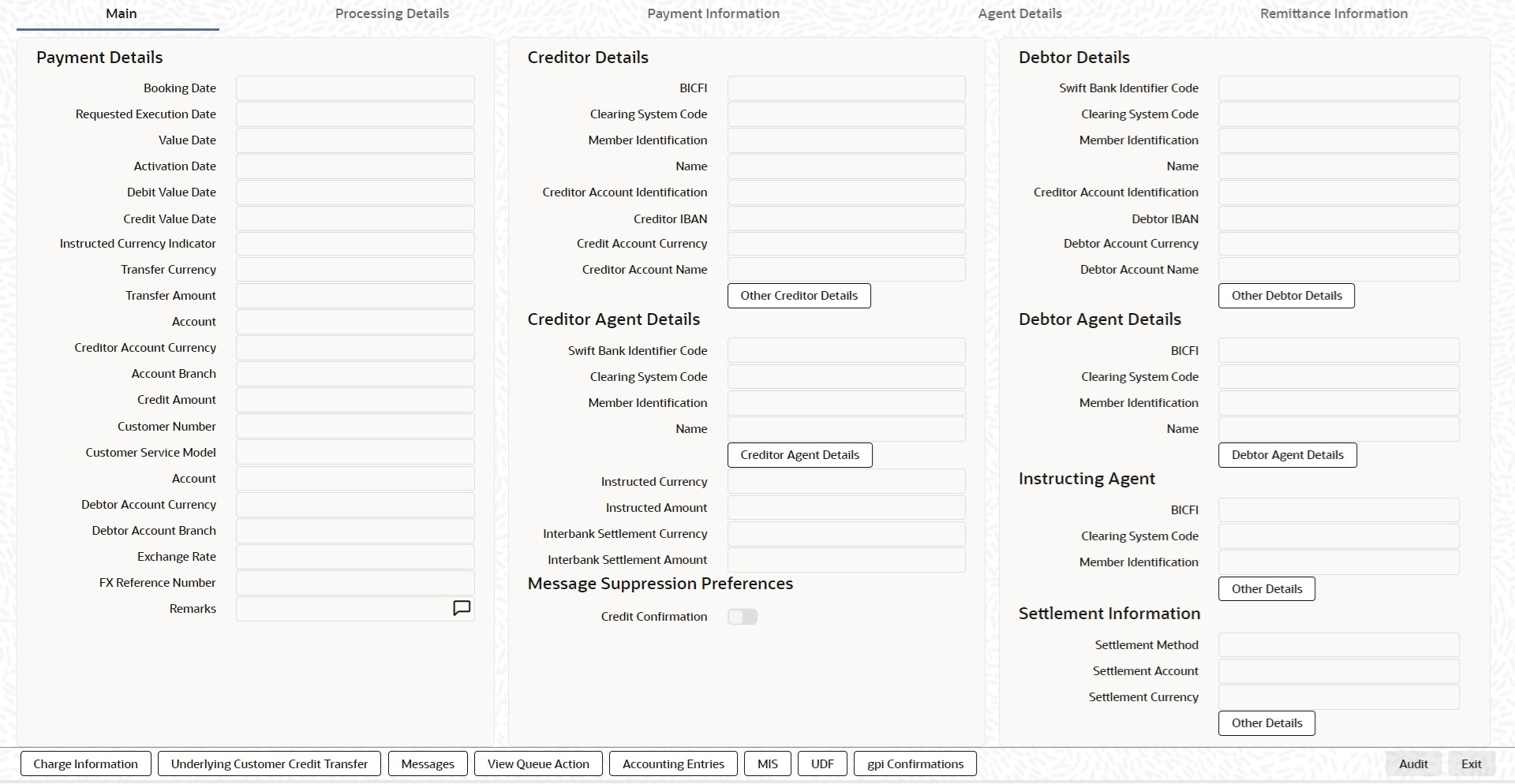

Navigate to the main screen Process Cross Border FI Credit Transfer View.
  1. From the main screen, select Main tab.
    The Main details are displayed.
    Figure 5-21 Cross Border FI Credit Transfer View_Main tab
  2. On Main Tab, specify the fields. For more information on fields, refer to the field description table below:
