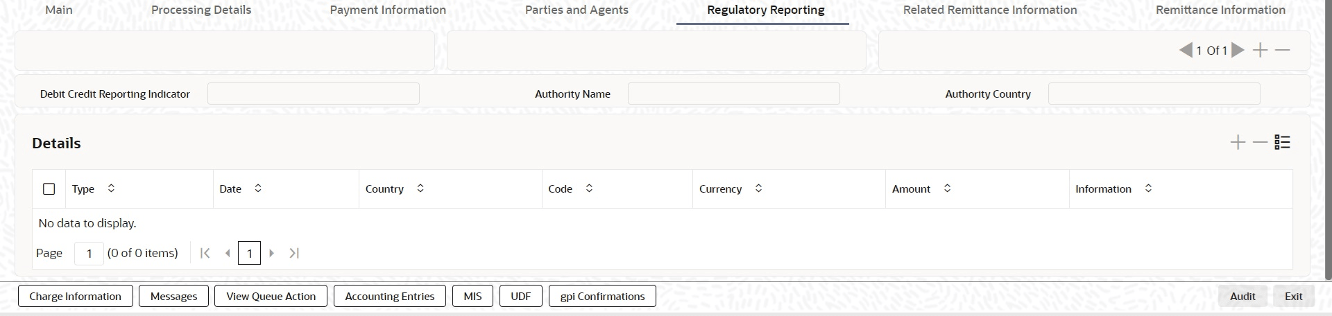

  1. From the main screen, select the Regulatory Reporting tab.
    The Regulatory Reporting tab is displayed.
    Figure 5-6 Cross Border FI to FI Customer Credit Transfer View - Regulatory Reporting Tab
    Description of Figure 5-6 follows
    Description of "Figure 5-6 Cross Border FI to FI Customer Credit Transfer View - Regulatory Reporting Tab"
  2. In the Regulatory Reporting tab, specify the fields. For more information on fields, refer to the field description table below:
