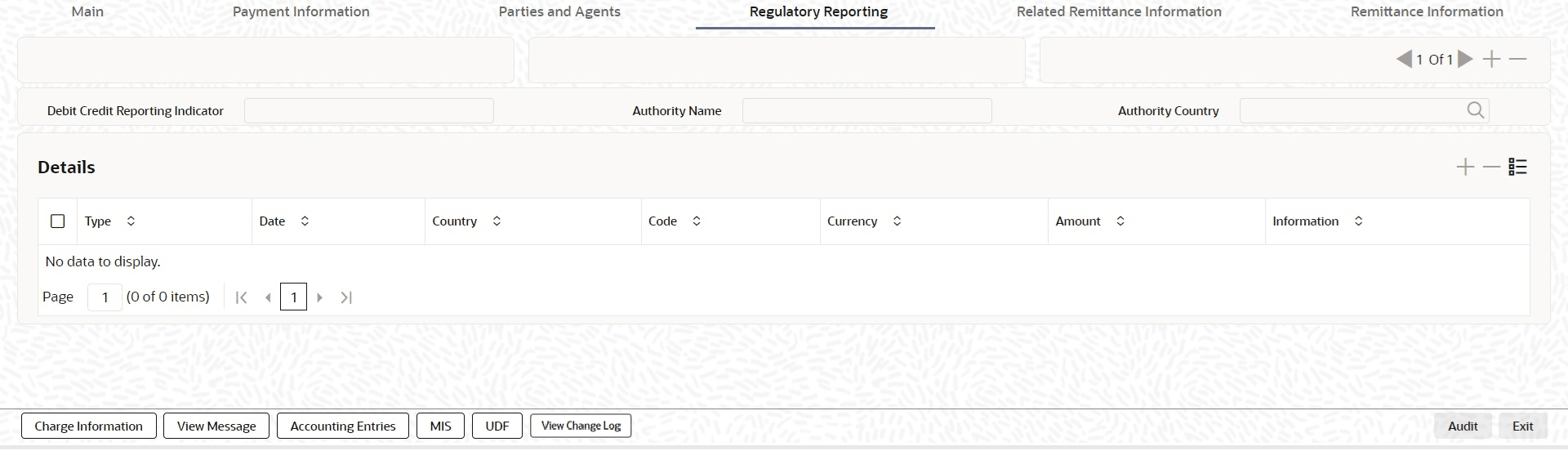

  1. From the main screen, select the Regulatory Reporting tab.
    The Regulatory Reporting details are displayed.
    Figure 4-19 Cross Border Inbound FI to FI Customer Credit Transfer Input - Regulatory Reporting Tab
    Description of Figure 4-19 follows
    Description of "Figure 4-19 Cross Border Inbound FI to FI Customer Credit Transfer Input - Regulatory Reporting Tab"
  2. On the Regulatory Reporting tab, specify the fields.
    For more information about the fields, refer to field description table.
