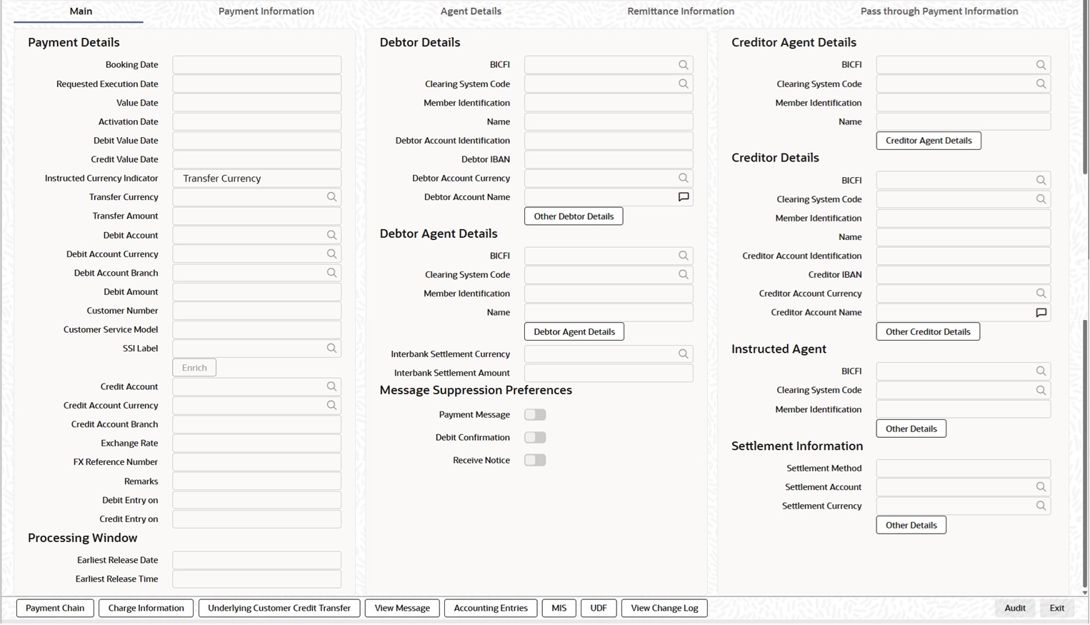

3.1.2.1 Process Main Tab
This topic explains the Main tab of the Cross Border Outbound FI Credit Transfer Input Detailed screen.
  1. From the main screen, select the Main tab.
    The Main details are displayed.
    Figure 3-46 Cross Border Outbound FI Credit Transfer Input Detailed - Main Tab
    Description of Figure 3-46 follows
    Description of "Figure 3-46 Cross Border Outbound FI Credit Transfer Input Detailed - Main Tab"
  2. On Main Tab, specify the fields.
    Table 3-45 Cross Border Outbound FI Credit Transfer Input Detailed_Main Tab - Field Description
    Field Description
    Payment Details
    This section displays the Payment Details.
    System defaults the following fields to current branch date:
    • Booking Date
    • Requested Execution Date
    • Value Date
    • Activation Date
    Debit Value Date The system derives the debit value date during transaction processing when the Enrich button is clicked. This field is disabled for user input.
    Credit Value Date The system derives the credit value date during transaction processing when the Enrich button is clicked. This field is disabled for user input.
    Instructed Currency Indicator Select Instructed Currency Indicator from the list of values.
    • Transfer Currency (Default)
    • Debit Currency
    Transfer Currency Specify the transfer currency.
    Transfer Amount Specify the transfer amount.
    LCY Mid-rate Equivalent Amount
    System displays the LCY Mid-rate Equivalent Amount.
    Debit Account Specify the debit account of customer from the list of values. This list contains all open and authorized customer accounts maintained in External Customer Account Input and GLs.
    Debit Account Currency System populates this field with the account currency based on the debit account selected.
    Debit Account Branch System populates this field with the account branch based on the debit account selected.
    Debit Amount Specify the debit amount. If you do not enter this value, the system populates this field based on specified transfer currency or amount.
    Customer Number System defaults the resolved customer number.
    Customer Service Model System defaults the customer service model of the resolved customer number.
    SSI Label Specify SSI Label from the list of values. The list of values displays all valid SSI Labels applicable for the customer and the network.
    Credit Account
    Specify the credit account of the currency correspondent.
    Note: If you do not specify the credit account, the system populates it with the derived Nostro/Vostro (mirror) account upon clicking the Enrich button.
    Credit Account Currency System populates this field with the account currency based on the credit account selected.
    Credit Account Branch System populates this field with the account branch based on the credit account selected.
    Exchange Rate Specify the Exchange Rate if the debit account currency differs from the transfer currency, or if the instructed currency is different from the transfer currency.
    FX Reference Number Specify the FX Reference Number.
    Remarks Specify the Remarks, if applicable.
    Debit Entry on Select Debit Entry on from the following:
    • Activation Date
    • Value Date
    Credit Entry on Select Credit Entry on from the following:
    • Activation Date
    • Value Date
    Debtor Details This section displays the following fields.
    BICFI Select the BICFI code from the list of values.
    Clearing System Code Select the Clearing System Code from the list of values.
    Member Identification Specify the member identification.
    Name Specify the name.
    Debtor Account Identification System defaults this field based on debit account selected. User can modify the account number.
    Debtor IBAN The system does not populate this field based on the debit account. You can update the account number manually.
    Debtor Account Currency Specify the currency of the selected debit account.
    Debtor Account Name Specify the debited account name.
    Other Debtor Details Button
    Click the Other Debtor Details button on the Main tab under the Debtor Details header to open the sub-screen. This screen displays the Debtor Details.
    Refer to the topic Main Tab - Other Details Button for details of fields and sub-screen of the Other Debtor Details button.
    Debtor Agent Details This section displays the following fields.
    Debtor Agent Details Button
    Click the Debtor Agent Details button on the Main tab under the Debtor Agent Details header to open the sub-screen. This screen displays the Debtor Agent Details.
    Refer to the topic Main Tab - Agent Details Button for details of fields and sub screen of the Debtor Agent Details button.
    Instructed Currency Specify Instructed Currency from the list of values.
    Instructed Amount Specify the debit amount.
    Interbank Settlement Currency System displays same as transfer currency.
    Interbank Settlement Amount System displays final amount resolved.
    Message Suppression Preferences This section displays the following fields.
    Payment Message (with cover) By default, the checkbox is unselected. If user selects the checkbox, payment message with cover message is suppressed.
    Debit Confirmation By default, the checkbox is unselected. If user selects the checkbox, debit confirmation (camt.054) is suppressed.
    Receive Notice By default, the checkbox is unselected. If user selects the checkbox, receive notice (camt.057) is suppressed.
    Creditor Agent Details This section displays the following fields.
    Note: Specify either BICFI or Clearing System Code/Member Identification.
    Member Identification Specify the Member Identification.
    Creditor Agent Details Button
    Click the Creditor Agent Details button on the Main tab under the Creditor Agent Details header to open the sub-screen. This screen displays the Creditor Agent Details.
    Refer to the topic Main Tab - Agent Details Button for details of fields and sub-screen of the Creditor Agent Details button.
    Creditor Details This section displays the following fields.
    Member Identification Specify the Clearing ID code.
    Name System defaults the name based on the selected BICFI code.
    Creditor Account Identification Specify the creditor account number.
    Creditor IBAN Specify the creditor IBAN.
    Creditor Account Currency Specify Credit Account Currency from the list of values.
    Creditor Account Name Specify the creditor account name.
    Other Creditor Details Button
    Click the Other Creditor Details button on the Main tab under the Creditor Details header to open the sub-screen. This screen displays the Creditor Details.
    Refer to the topic Main Tab - Other Details Button for details of fields and sub-screen of the Creditor Details button.
    Instructed Agent This section displays the following fields.
    BICFI Specify BICFI code from the list of values.
    Clearing System Code Specify Clearing System Code from the list of values.
    Member Identification Specify the clearing ID code.
    Other Details Button Click Other Details button on Main tab under Instructed Agent header to process the screen. This screen shows the Instructed Agent Details.
    Settlement Preference This section displays the following fields.
    Settlement Method Select the Settlement Method for transaction from the list of values.
    • INDA
    • INGA
    Settlement Account Select the Settlement Account from the list of values.
    Settlement Currency Settlement Currency is populated based on the selected Settlement Account.
    Other Details Button Click the Other Details button on Main tab under Settlement Information header to process the screen. This screen shows the Settlement Information Details.

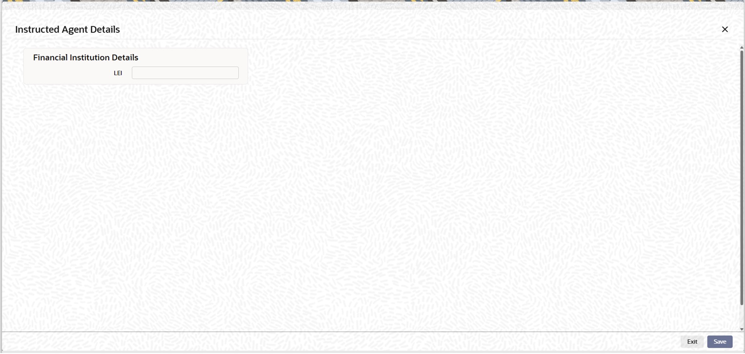

  3. Click the Other Details button on the Main tab under Instructed Agent header.
    The Instructed Agent Details sub-screen is displayed.
    Figure 3-47 Main Tab_Other Details - Instructed Agent Details
    Description of Figure 3-47 follows
    Description of "Figure 3-47 Main Tab_Other Details - Instructed Agent Details "
  4. On the Instructed Agent Details screen, specify the fields.
    Table 3-46 Main Tab_Other Details - Instructed Agent Details
    Field Description
    Financial Institution Details This section displays the Financial Institution Details.
    LEI Specify LEI of the agent.

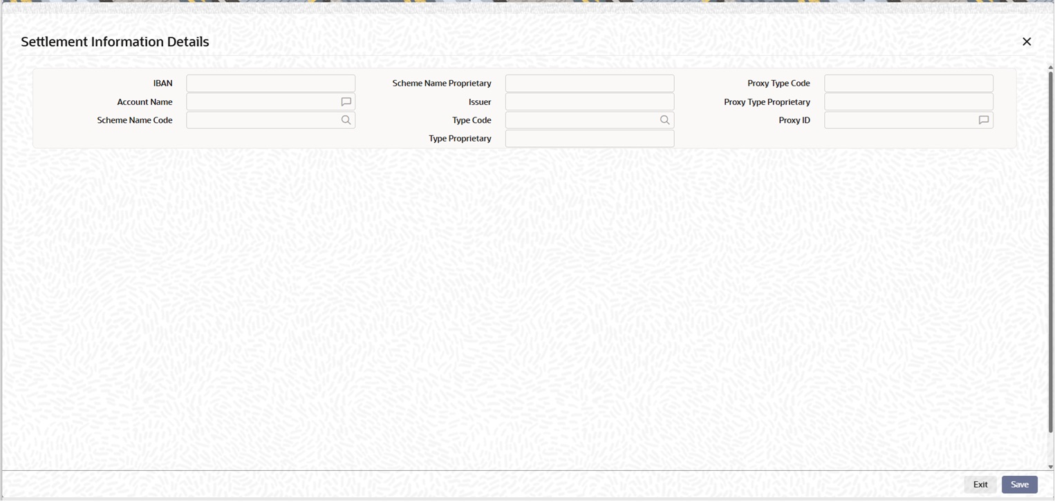

  5. Click the Other Details button on the Main tab under Settlement Information header.
    The Settlement Information Details sub-screen is displayed.
    Figure 3-48 Main Tab_Other Details - Settlement Information Details
    Description of Figure 3-48 follows
    Description of "Figure 3-48 Main Tab_Other Details - Settlement Information Details "
  6. On the Settlement Information Details screen, specify the fields.
    Table 3-47 Main Tab_Other Details - Settlement Information Details
    Field Description
    Settlement Institution Details This section displays the Settlement Institution Details.
    IBAN System defaults IBAN of the agent based on the specified settlement account.
    Scheme Name Proprietary Specify the Scheme Name Proprietary of the agent.
    Proxy Type Code Select Proxy Type Code from the list of values.
    • TELE
    • EMAL
    • DNAM
    Account Name System defaults the account name of the agent based on the specified settlement account.
    Issuer Specify the issuer of the agent.
    Proxy Type Proprietary Specify the Proxy Type Proprietary of the agent.
    Scheme Name Code Specify Scheme Name Code of the agent from the list of values.
    Type Code Specify Type Code for the agent from the list of values.
    Proxy ID Specify the Proxy ID of the agent.
    Type Proprietary Specify the Type Proprietary of the agent.
