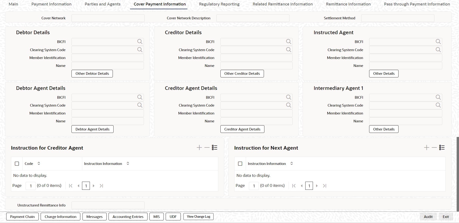

  1. From the main screen, select the Cover Payment Information tab.
    The Cover Payment Information details are displayed.
    Figure 3-17 Cross Border Outbound FI to FI Customer Credit Transfer Input - Cover Payment Information Tab
    Description of Figure 3-17 follows
    Description of "Figure 3-17 Cross Border Outbound FI to FI Customer Credit Transfer Input - Cover Payment Information Tab"
  2. On the Cover Payment Information tab, specify the fields.
    Table 3-17 Cross Border Outbound FI to FI Customer Credit Transfer Input Detailed_Cover Payment Information Tab - Field Description
    Field Description
    Cover Network System displays the network derived for the cover message.
    Cover Network Description System displays the description of the derived cover network.
    Settlement Method System displays the derived settlement method for the cover message.
    Debtor Details This section displays the following fields.
    BICFI Select the BICFI code from the list of values.
    Clearing System Code Select the Clearing System Code from the list of values.
    Member Identification Specify the member identification.
    Name Specify the name of the debtor.
    Other Details Button
    Click the Other Debtor Details button in the Cover Payment Information tab under Debtor Details header to process the sub-screen. This screen shows the Debtor Details.
    For more details, refer to the topic Cover Payment Information Tab - Other Details Button.
    Debtor Agent Details This section displays the following fields.
    Click the Debtor Agent Details button in the Cover Payment Information tab under Debtor Agent Details header to process the sub-screen. This screen shows the Debtor Details.
    Creditor Details This section displays the following fields.
    Name Specify the name of the creditor.
    Click the Creditor Details button in the Cover Payment Information tab under Creditor Details header to process the sub-screen. This screen shows the Creditor Details.
    Creditor Agent Details This section displays the following fields.
    Click the Creditor Details button in the Cover Payment Information tab under Creditor Agent Details header to process the sub-screen. This screen shows the Creditor Details.
    Instructed Agent This section displays the following fields.
    Name Specify the name of the instructed agent.
    Other Details Button Click the Other Details button in the Cover Payment Information tab under Instructing Agent header to process the sub-screen. This screen shows the Instructing Agent Details.
    Intermediary Agent 1 This section displays the following fields.
    Name Specify the name of the intermediary agent.
    Click the Other Details button in the Cover Payment Information tab under Intermediary Agent 1 to open the sub-screen. This screen shows the Intermediary Agent 1 Details.
    Instruction for Creditor Agent This section displays the following fields.
    Code 1 Select the Code from the list of values.
    Instruction Information Specify the instruction information.
    Note: System allows only 2 occurrences of instruction for creditor agent.
    Instruction for Next Agent This section displays the following fields.
    Instruction Information Specify the instruction information to be given to the next agent in the payment chain.
    Note: System allows only 2 occurrences of instruction for next agent.
    Unstructured Remittance Info Specify the unstructured remittance information.

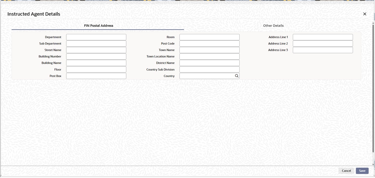

  3. Click the Other Details button under Instructed Agent of the Cover Payment Information tab.
    The Instructed Agent Details sub-screen is displayed.
    Figure 3-18 Other Details_Instructed Agent Details - FIN Postal Address
    Description of Figure 3-18 follows
    Description of "Figure 3-18 Other Details_Instructed Agent Details - FIN Postal Address"
  4. On the FIN Postal Address tab, specify the fields.
    For more information about the fields, refer to field description table.
    Table 3-18 Cover Payment Information Tab - Other Details Button - FIN Postal Address Tab - Field Description
    Field Description
    Department Specify the department.
    Sub Department Specify the sub-department.
    Street Name Specify the street name.
    Building Number Specify the building number.
    Building Name Specify the building name.
    Floor Specify the Floor.
    Post Box Specify the post box name.
    Room Specify the Room.
    Post Code Specify the post code.
    Town Name Specify the town name.
    Town Location Name Specify the town location name.
    District Name Specify the district name.
    Country Sub Division Specify the country sub division.
    Country Select the Country from the list of values.
    Address Line 1 Specify the Address Line 1
    Address Line 2 Specify the Address Line 2
    Address Line 3 Specify the Address Line 3
  5. Click the Other Details tab to specify the fields.
    The Other Details are displayed.
    Figure 3-19 Other Details_Instructed Agent Details - Other Details
    Description of Figure 3-19 follows
    Description of "Figure 3-19 Other Details_Instructed Agent Details - Other Details"
  6. On the Other Details tab, specify the fields.
    Table 3-19 Cover Payment Information Tab - Other Details Button - Other Details Tab - Field Description
    Field Description
    Financial Institution Details This section displays the following fields.
    LEI Specify LEI of the agent.
    Branch Details This section displays the following fields.
    Identification Specify Identification of the branch.
