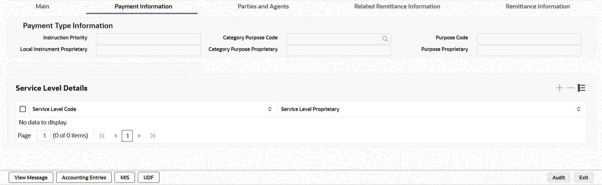

  1. From the main screen, select the Payment Information tab.
    The Payment Information details are displayed.
    Figure 2-32 Fedwire ISO Outbound Drawdown Request Detailed_Payment Information Tab
  2. On the Payment Information tab, specify the fields.
    Table 2-27 Fedwire ISO Outbound Drawdown Request Detailed_Payment Information Tab - Field Description
    Field Description
    Payment Type Information This section displays the Payment Type Information details.
    Instruction Priority Select the instruction priority from the drop-down list. The list displays the following options:
    • HIGH
    • NORM
    Local Instrument Proprietary
    Specify the Local Instrument Proprietary value.
    Category Purpose Code Select the Category Purpose Code from the list of values. This list contains ISO 20022 category purpose codes.
    Category Purpose Proprietary Specify the Category Purpose Proprietary value.
    Purpose Code Select the Purpose Code from the list of values. This list contains ISO 20022 purpose codes.
    Purpose Proprietary
    Specify the Purpose Proprietary value.
    Service Level Details
    Service Level Code Select from the list of values for Service Level Code. This list contains ISO 20022 Service Level codes.
    Service Level Proprietary
    Specify the Service Level Proprietary.
    • Only three occurrences of Service Level are allowed.
    • If you input Service Level, specify either Code or Proprietary.
